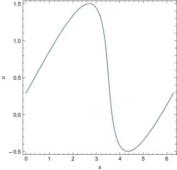

There are a handful of scientific plotting programs that are able to plot implicit equations.
For instance, the following piece of code in Mathematica produces a plot of the solution in the $(x,u)$ plane for $t = 0.75$
ContourPlot[u == 1/2+Sin[x - u*0.75], {x, 0, 2*Pi}, {u, -0.5, 1.5}]
You can see what happens as you progress in time (in particular when you approach $t \to 1$) by introducing $t$ as some variable and embedding the snippet in a loop. Perhaps this is done more efficiently in Matlab though.

    @mint Note that this method will provide a correct plot of the solution until the time where a shock occurs, i.e. the breaking time $t_B=\frac{−1}{\min ∂_x u(x,0)} = 1$. See e.g. this post. – EditPiAf Dec 05 '17 at 18:49
