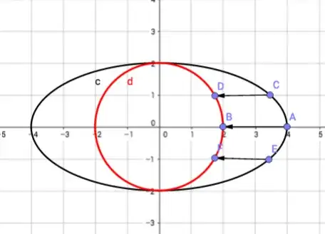

I think that this figure can help the intuition.
The ellipse is the curve $x^2+4y^2=16$ and the circle is the curve after the contraction $x \to \frac{x}{2}$.
