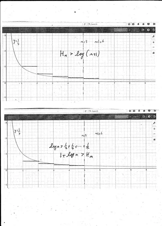

I will try to work up some kind of drawing. As in a comment, the most elementary aspects of proof of the Integral Test give this: writing $$ H_n = 1 + \frac {1}{2} + \frac {1}{3} + \cdots + \frac {1}{n}, $$ we get the very ordinary $$ H_n > \log ( n+1) $$ and $$ H_n < 1 + \log n. $$ Here the logarithm is base $e \approx 2.71828.$
I drew in color, but my scanner does poorly with graph paper in color enter image description here
Will Jagy
