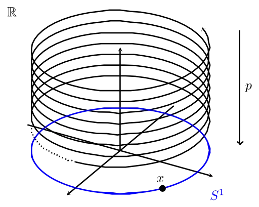

A natural way to visualize the isomorphism $\mathbb{R}/\mathbb{Z} \cong S^1 $, induced from the epimorphism $ p \colon \mathbb{R} \to S^1 $ defined by $ p(t) = e^{2\pi it}$ for $ t \in \mathbb{R} $ with $ \ker p = \mathbb{Z} $, is the following (though which does not work well in general).
