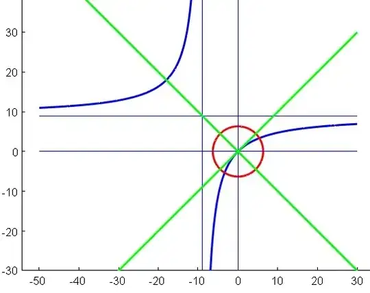

This solution is based on a geometrical reasoning (see picture below)
Let $$\tag{1}f(x):=\dfrac{9x}{x+9} \ \ \text{and} \ \ V_x=\binom{x}{f(x)}.$$
The initial condition can be written under the equivalent form:
$$\tag{2}\|V_x\|^2=40.$$
Said otherwise, we are looking for points on hyperbola $(H)$ given by (1) that are at distance $d:=2\sqrt{10}$ from the origin. Graphical representation indicates that there are two solutions (the abscissas of the intersection points with $(H)$ of the circle centered at the origin with radius $d$).
In order to find them, it is advantageous to rotate the axes by a $\pi/4$ angle around the origin (in this way the abscissas of the intersection points are opposite one to the other ; we can thus expect a degree diminution...)
As this transformation is given by change of coordinates :
$$\tag{3}\begin{cases}x=\tfrac{X-Y}{\sqrt{2}}\\y=\tfrac{X+Y}{\sqrt{2}}\end{cases}$$
(old coordinates expressed as function of new coordinates, as usual), we get the equation of $(H)$ with respect to the new (green) axes, under the form:
$$\tag{4}(Y-9\sqrt{2})^2-X^2=162 \ \ \iff \ \ Y=9\sqrt{2}-\sqrt{162+x^2}$$
(the last equation is the equation of the lower right branch of $(H)$, the only interesting one).
A parameterization of $(H)$ with respect to these new axes is : $$\tag{5}\begin{cases}(a) &X=\tfrac{-18\sqrt{2}t}{t^2-1}\\(b) &Y=tX=\tfrac{-18\sqrt{2}t^2}{t^2-1}\end{cases}$$
Remark : this parameterization is obtained in the classical way (non trivial intersections of $(H)$ with a rotating straight line $Y=tX$).
Expressing (see relationship (2)) that $X^2+Y^2=40$ (rotations preserve norms), we get a fourth degree equation :
$$\tag{6}81(t^2+t^4)=5(t^2-1)^2$$
(with only even powers of $t$, as expected). Setting $T=t^2$, we have a quadratic equation whose only positive solution is $T=\tfrac{1}{19}$ ; thus $t=\pm \tfrac{1}{\sqrt{19}}$. Plugging these values into (5)(a) and (b), we get values for $X$ and $Y$, and finally values of $x$ by using (3):
$$\tag{7} x=1\pm\sqrt{19}$$
which can be checked to be the real roots of the initial fourth degree equation :
$$\tag{8}x^4+18x^3+122x^2-720x-3240=0$$
Remark : Polynomial $x^2-2x-18$ whose roots are given by (7) divides the polynomial in the LHS of (8), with quotient $x^2+20x+180$ whose roots $x=-10 \pm i 4 \sqrt{5}$ are the complex roots of (8).
