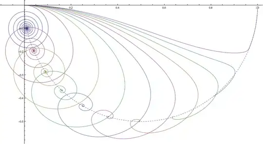

I tried to get an exact solution of the above differential equations with Mathematica, but to no avail. But they can be solved numerically: I plotted the resulting dog's path for ten values of $v/\omega$, from $0.1$ to $1$ (picture below). In any case the path reaches asymptotically the corresponding halting point. For small values of $v/\omega$, this occurs after a long spiralling around it. For values near to $1$ there is no spiral.
As one could expect, for $v/\omega<1$ the dog doesn't catch the goose. For $v/\omega>1$ dog's path is very similar to the one shown above for $v/\omega=1$, and numerical solutions show that the dog arrives at $G$ in a finite time (which is quite obvious). For $v/\omega=1$ I expect the dog doesn't arrive there in a finite time, but that is hard to tell from a numerical solution.
