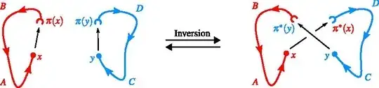

This permutation has therefore exactly $C(\pi^*) = C(\pi)+1$ cycles. From this permutation, using one inversion, we can construct another $n$ distinct permutations ${\pi^*_i}_{i=1}^n$ of the form
$$\pi^*_i = \begin{pmatrix} 1 & 2 & 3 & \cdots & i & \cdots & n & n+1 \\ \pi(1) & \pi(2) & n+1 & \cdots & n & \cdots & \pi(n) & \pi(i) \end{pmatrix}$$
The number of cycles of $\pi^*_i$ is one less than $\pi^*$ since the inversion merged two disjoint cycles, therefore $C(\pi^*_i)=C(\pi)$ (see the image below for an explanation, there $\pi^*$ stands for a composition of $\pi$ with the inversion of elements $x,y$).
inversion merges two disjoint cycles
We have not disrupted, however, the order of numbers ${1,2,3,\dots,n}$ so there exist an injection from $\pi^*_i$ to $\pi$. The total number of $\pi^*_i$ permutations is therefore $n n!$, together with $\pi^*$ permutations we have constructed $nn!+n! = (n+1)!$ distinct permutations so we have covered all permutations in $S_{n+1}$. Therefore
