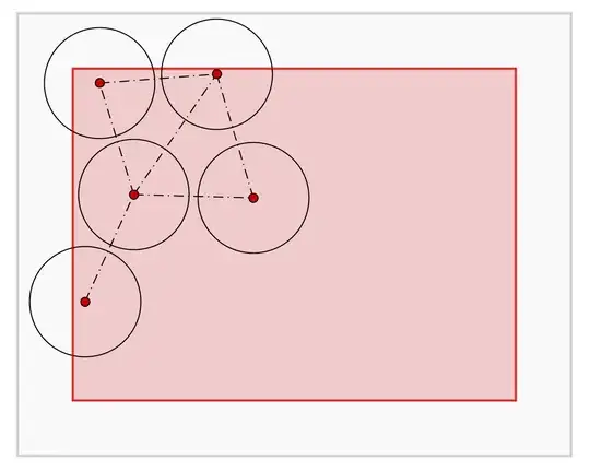

No, it is not. If we assume that $P_1,P_2,\ldots,P_{26}$ are $26$ distinct points inside the given rectangle, such that $d(P_i,P_j)\geq 5\,cm$ for any $i\neq j$, we may consider $\Gamma_1,\Gamma_2,\ldots,\Gamma_{26}$ as the circles centered at $P_1,P_2,\ldots,P_{26}$ with radius $2.5\,cm$. We have that such circles are disjoint and fit inside a $25\,cm \times 20\,cm$ rectangle. That is impossible, since the total area of $\Gamma_1,\Gamma_2,\ldots,\Gamma_{26}$ exceeds $500\,cm^2$.

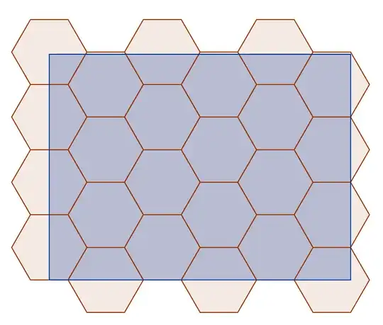

Highly non-trivial improvement: it is impossible to fit $25$ points inside a $20\,cm\times 15\,cm$ in such a way that distinct points are separated by a distance $\geq 5\,cm$.
Proof: the original rectangle can be covered by $24$ hexagons with diameter $(5-\varepsilon)\,cm$. Assuming is it possible to place $25$ points according to the given constraints, by the pigeonhole principle / Dirichlet's box principle at least two distinct points inside the rectangle lie in the same hexagon, so they have a distance $\leq (5-\varepsilon)\,cm$, contradiction.

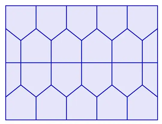

Further improvement: enter image description here
the depicted partitioning of a $15\,cm\times 20\,cm$ rectangle $R$ in $22$ parts with diameter $(5-\varepsilon)\,cm$ proves that we may fit at most $\color{red}{22}$ points in $R$ in such a way that they are $\geq 5\,cm$ from each other.

  • +1 for the circle area exceeds the available area method! We always used to divide the shape into some holes and consider the points as pigeons seated in the holes. – AHB Jun 12 '17 at 05:10
  • As the OP hasn't "learned any mathematical ways to find a solution", it would be good to include the reason for choosing hexagons. – ShadSterling Jun 12 '17 at 13:56
    I find your use of (5−ε) confusing, and I think it's unnecessary; it should be enough to show that the hexagonal tessellation from any corner (which provides the optimal packing of points) will fill the rectangle with less than 26 hexagons. – ShadSterling Jun 12 '17 at 14:01
    The reason for choosing hexagons is that an hexagonal tiling gives an optimal circle packing in the plane, if we do not have further constrains. But as you can see, constraints matter a lot: the last modified pentagonal tiling proves a better bound for the current problem, and the optimal packing in the given rectangle is probably a square packing. – Jack D'Aurizio Jun 12 '17 at 14:02
  • "the hexagonal lattice is the densest of all possible circle packings" -- https://en.wikipedia.org/wiki/Circle_packing#Packings_in_the_plane; the only cases where hex tiling is not optimal are where the circles are not all the same size or where the surface is not a plane. – ShadSterling Jun 12 '17 at 18:09
    @Polyergic: without additional constraints: a rectangle is not the whole plane. The hexagonal lattice is clearly non-optimal in a $2\times 2$ square, for instance. You can fit $9$ points with mutual distances $\geq 1$ with a square lattice, way less with an hexagonal lattice. – Jack D'Aurizio Jun 12 '17 at 18:18
    @Polyergic: the wild behaviour of the constrained problem is pretty clear from this Wikipedia page (https://en.wikipedia.org/wiki/Circle_packing_in_a_square) - sometimes the optimal packing is close to a square packing, sometimes it is closer to an hexagonal packing. – Jack D'Aurizio Jun 12 '17 at 18:22
    I find the first part of the answer dubious. The total area of the circles doesn't matter because only their centers need to be inside the rectangle. Using that argument, you can't place 4 points inside a 5x5 square, because the area of 4 circles exceeds 25cm^2. But actually you can just place a point at each corner. – Andre Jun 13 '17 at 14:01
    @Andre: this answer works as it is. If you like to use a different argument for proving something else, feel free to do it, but there isn't anything dubious in the first part. $26$ disjoint circles with total area $\geq 510,cm^2$ cannot fit in a $500,cm^2$ rectangle (that, again, is the area of an enlarged rectangle, not the original one), that is all I am saying. – Jack D'Aurizio Jun 13 '17 at 14:03
    You can place $4$ points in a $5\times 5$ square, because the area of four circles is less than $(5\color{red}{+5})^2,cm^2$. – Jack D'Aurizio Jun 13 '17 at 14:06
    Yes, you are correct. I have overlooked that you are talking about an enlarged area, which is crucial to the argument. Thanks for the clarification. – Andre Jun 13 '17 at 14:10
