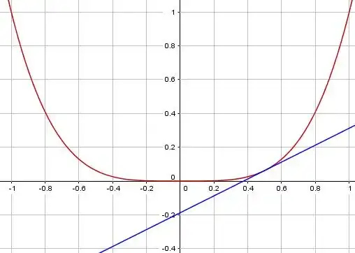

But (see figure below for the case $k=4$) :
$$x_0 \ \text{is a multiple root of} \ f(x)= x^k + cx + t \ \ \ \iff \ \ \text{curves of} \ \begin{cases}y&=&x^{k}\\y&=&-cx-t \end{cases} \ \text{have a double point}$$
Said otherwise, multiple roots occur as double roots each time the straight line $L$ with equation $y=-cx-t$ is tangent to the curve $(C_k)$ with equation $y=x^k$. In fact no other cases exist as we will check later on.
As the equation of the tangent to curve $(C_k)$ at point $P$ with abscissa $x_0$ is
$$\tag{1}y-x_0^k=kx_0^{k-1}(x-x_0) \ \ \ \ \iff \ \ \ \ y=kx_0^{k-1}x+(1-k)x_0^k,$$
it suffices now to identify the coefficients of (1) with those of $y=-cx-t$, giving
$$\begin{cases}-c&=&kx_0^{k-1}\\-t&=&(1-k)x_0^k \end{cases}\ \ \ \ \iff \ \ \ \ \begin{cases}x_0^{k-1}&=&-\dfrac{c}{k}& \ \ \ (a)\\x_0^k&=&\dfrac{t}{k-1} & \ \ \ (b) \end{cases} $$
Raising (a) to the power $k$ and (b) to the power $k-1$, and equating the RHSides, one gets:
$$(-1)^k\dfrac{c^k}{k^k}=\dfrac{t^{k-1}}{(k-1)^{k-1}},$$
which is equivalent to the condition "discriminant $ \ = \ 0$", up to a constant factor.
