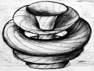

A fiber bundle $F\to E\to B$ may be interpreted as $E$ being a bunch of $F$s arranged in the shape of a $B$. For instance, a Mobius band $M$ is a bunch of line segments $[0,1]$ arranged in the shape of a circle $S^1$, so we may write $[0,1]\to M\to S^1$.
The Hopf fibration $S^1\to S^3\to S^2$, then, says that $S^3$ may be interpreted as a bunch of circles $S^1$ arranged in the shape of a sphere $S^2$. Via stereographic projection, $S^3$ may be interpreted as the one-point compactification of $\mathbb{R}^3$, or in other words $\mathbb{R}^3$ with a "point at infinity."
$\hskip 0.5in$ hopf fibration
(Artist depiction by Lun-Yi Tsai from here.)
This can be visualized. A vertical line with the point at infninity is a generalized circle, which corresponds to the north pole of the base space $S^2$, while a specific circle around that line corresponds to the south pole of $S^2$. Everywhere in between is a torus which is a circle's worth of circles, just as in between the north and south pole of $S^2$ there are circles' worths of points.

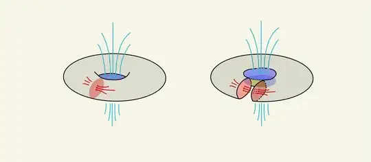

In the picture below, I consider one choice of a solid torus, say the one which is the preimage of the southern hemisphere of the target. It has two caps, which are the disks bounded by the longitude (blue) and meridian (red). The right picture depicts the result of the symmetric surgery on the torus: this is an ambient surgery which uses both disks at once. We see that the resulting sphere (the union of grey, two blues, two reds and the yellow square) intersects all fibres.
Symmetric surgery
Note that using any one of the caps to do surgery would also turn the torus into a sphere, but it would not produce a family of surjective maps as I wanted.
So let us foliate $\mathbb{S}^3$ by tori and the two circles (the blue one $N\cup ∞$ and the red one $S$) and pick caps on all tori. For example, all blue caps are disks centred at origin in the $xy$-plane and all red caps are in the $xz$-plane with boundary containing the origin. When we do symmetric surgeries on all the tori, we will make sure that the yellow region grows around the longitude and shrinks around the meridian, until it collapses to the red unit circle. Symmetrically in the other direction.
Each $f_t$ is almost a $2$-to-$1$ map from $\mathbb{S}^2$ to itself, since each fibre -- except those contained in the corresponding torus for $f_t$ -- intersects each of the spheres in the family precisely twice. Note that the local degrees at those points of the intersection are $+1$ and $-1$ (since the two push-offs of a cap are oppositely oriented), giving the total degree $0$.
You can now pretty much visualise how each $f_t$ looks like. For example, the one from the picture will send the grey region to the equator of the target, the red disks will got the southern hemisphere and the blue disks will go to the northern.

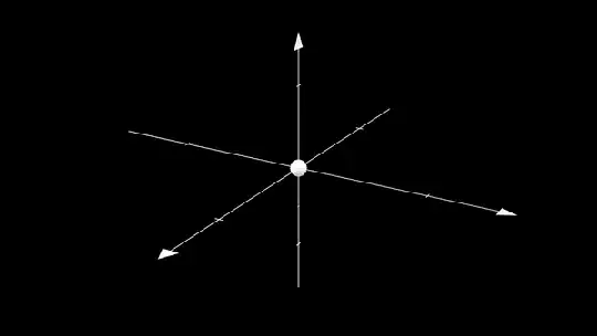

Here is one visualization:
hopf visualization
I uploaded a higher-quality render to youtube.
To make things slightly easier to see, I am using the codomain $\mathbb{R}^3 \setminus 0 \simeq S^2$. This way, you can see the two layers of the balloon move past each other instead of being on top of each other.
The animation is still a bit visually busy, so here is what is happening in words:
  • The balloon starts as compressed to a single point at the south pole.
  • The two layers of the balloon slowly begin to wrap around the sphere.
  • As the two layers are engulfing the sphere, the inner layer twists more than the outer layer.
  • When the balloon has reached all the way to the north pole, the entire inner layer has twisted by exactly a half turn.
    • At this point, all of the balloon's meridian great circles (one is highlighted in red) have constant longitude (mod $\pi$) on the target sphere; they live in a meridian great circle on the target sphere. Each meridian just wraps twice around.
    • If this were a physical rubber balloon, it would get stuck. But since the balloon is allowed to pass through itself, it can just continue rotating, doing the reverse of the way it got to that point, except continuing to twist in the same direction.
  • The inner layer continues to twist around in the same direction as both layers contract back down to the south pole. By the end, the inner layer has done one full twist.
The above smooth map should be homotopic to a three-part map that first does all the engulfing, then does one complete twist of the inner layer, then does all the un-engulfing/retreating. The three-part map would no longer be so smooth, but it would make the group operation clear: two copies of this animation played successively (engulf, twist, retreat, engulf, twist, retreat) are then homotopic to just one (engulf, twist twice, retreat). During the middle stage, one can in fact do any number of inner-layer twists, in either direction, which makes it believable that $\pi_3(S^2)\cong\mathbb{Z}$.
The heart of the visualization is this parameterization:
def hopf(u, v, t):
    Given a point (u, v) in stereographic coordinates on S^2
    and a time t, return the point (x,y,z) in this animation.
    u2, v2, t2 = u**2, v**2, t**2
    norm2 = (u2 + v2 + t2 + 1)**2
    conj = u2 + v2 + t2 - 1
    x, y, z = (
        (4*v*conj - 8*u*t) / norm2,
        (4*u*conj + 8*v*t) / norm2,
        (4*u2 + 4*v2 - 4*t2 - conj**2) / norm2,
    return x, y, z
There are a couple more tweaks on top of this for the two separate layers and to make the domain something smaller than just all of $\mathbb{R}^2$, but this is the gist of it.
