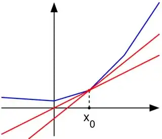

However, the notion of differentiation can be extended to super-differentials and sub-differentials. These are linear functions with a slope such that the target function's graph lies entirely above or below the slope, near the point in question. Something like this:
sub-differential
This leads to the notion of viscosity super-solution and sub-solutions. For example if the PDE is of the form: $$F(x, v(x), \nabla v(x)) = 0$$ where $v$ is the value function, the viscosity sub-solution is defined by: $$F(x,V(x),\xi) \le 0 \quad \forall \xi\in D^+v(x), \forall x $$ where $\xi \in D^+$, the set of all super-differentials at point $x$.
