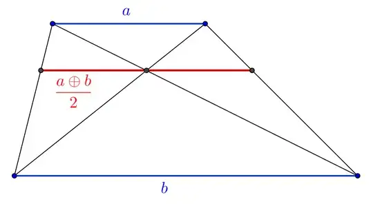

Does that have interesting applications? It might. The parametrization of varieties is a hot topic in algebraic geometry, for instance: the problem is often solved by showing the existence of a group structure on a geometric object. And in Euclidean geometry, the strange sum induced by $f(x)=\frac{1}{x}$ plays a major role in trapezoids:
As already mentioned, the strange sum induced by $f(x)=\frac{1}{x}$ also appears (by Kirchhoff's laws) in the formulas for the resistance of some resistors in parallel and for the capacitance of some capacitors in series.
