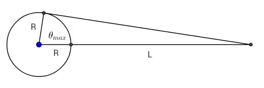

Above is a sketch of the Earth seen from the side, with the North Pole on top. $R$ is the radius of the Earth, $L$ is the distance from the Earth's surface to the Clarke Belt and $\theta_{max}$ is the maximum latitude where the belt is visible. We see that $$\cos \theta_{max} = \frac{R}{R+L}\tag {1}$$ If you select some latitude $\theta \lt \theta_{max}$ you will have the situation below:

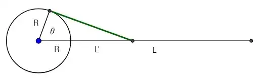

The tangent to the Earth at this latitude will intersect the segment $L$ at some shorter distance $L'$ above the Earth. We see that: $$\cos \theta = \frac{R}{R+L'}\tag{2}$$

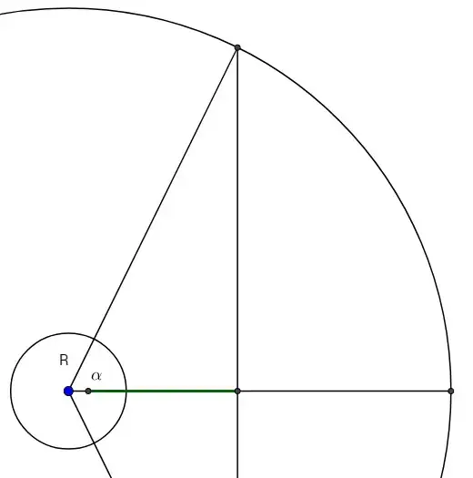

Looking at the above situation from the North Pole, we get the figure below:
From this figure we see that $$\cos \alpha = \frac{R+L'}{R+L}\tag{3}$$ Combining equations $1$ and $2$ with $3$ we find that $$\alpha = \arccos(\frac{\cos \theta_{max}}{\cos \theta})$$

  • Thank you AGAIN, Jens. I think you forgot to multiply $\alpha$ by 2. My own solution was (like yours) $2*\arccos(\sec(\frac{latitude}{\sec(81.38)}))$. I think that works out to the same thing, except for my coefficient. And you're right: no 3D trig needed. – N. Joseph Potts Jun 06 '17 at 20:29
  • Formula in my comment is wrong. Should be $2*\arccos(\frac{\sec(latitude}{\sec(81.38)}))$. It's going to be a long time before I get much good at this. – N. Joseph Potts Jun 06 '17 at 20:37
