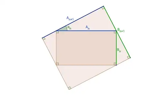

Recently I came up with an algebra problem with a nice geometric representation. Basically, I would like to know what happens if we repeatedly circumscribe a rectangle by another rectangle which is rotated by $\alpha \in \left( 0, \frac {\pi} {4}\right)$ radians. Use this picture as reference:
In particular, do the resulting rectangles converge to a square?
It is rather easy to show that the rectangles do converge to a square if $\alpha$ is constant throughout the process. However, if we make it more general by defineing a sequence $\left(\alpha_n\right)_{n=1}^{\infty}$ of angles and use $\alpha_i$ in the $i$'th operation, then the answer seems to depend on the chosen sequence. So, for which sequences $\left(\alpha_n\right)_{n=1}^{\infty}$ do the rectangles converge to a square?
Algebraically this problem can be defined like this:
Define two real sequences by $A_0=a, B_0=b, a \neq b, a,b \in R_{\gt0}$ and $A_{n+1}=B_n\sin\alpha_n + A_n\cos\alpha_n, B_{n+1}=A_n\sin\alpha_n + B_n\cos\alpha_n \forall n \in N_{\gt 0}$, where $\alpha_i \in \left( 0, \frac {\pi} {4}\right) \forall i \in N_{\ge 0}$. Is it true that $\lim_{n \to \infty}\frac{A_n}{B_n}=1$?

Using a little linear algebra, we can actually write sufficiently explicit formulas for $A_n$ and $B_n$ to confirm your conjecture, namely that the divergence of $\sum_{i = 1}^{\infty} \alpha_i$ is sufficient and necessary.
First, by writing the recurrence relations for $A_n$ and $B_n$ in matrix notation and applying a straightforward induction, we get that, for all nonnegative integers $n$, $$\require{cancel} \pmatrix{A_n \\ B_n} = \left(\prod_{i = 1}^n \underbrace{\pmatrix{\cos \alpha_i & \sin \alpha_i \\ \sin \alpha_i & \cos \alpha_i}}_{\Gamma_i}\right) \pmatrix{a \\ b} . $$ We can make this more explicit by employing the standard trick of diagonalization: The eigenvalues of $\Gamma_i$ are $\lambda_i^{\pm} := \cos \alpha_i \pm \sin \alpha_i$, so for $\alpha_i$ in the given range, we have that $$0 < \lambda_i^- < \lambda_i^+ ,$$ and in particular the eigenvalues are distinct, guaranteeing that we can write $$\Gamma_i = P_i \pmatrix{\lambda_i^- & 0 \\ 0 & \lambda_i^+} P_i^{-1}$$ for some $P_i$. In fact, since the rotations $\Gamma_i$ all commute with one another (and are diagonalizable) they are simultaneously diagonalizable, that is, we can choose all of the $P_i$ to be the same matrix $P$. Computing eigenvectors corresponding to the eigenvalues shows that we may take $$P = \pmatrix{\frac{1}{\sqrt{2}} & \frac{1}{\sqrt{2}} \\ -\frac{1}{\sqrt{2}} & \frac{1}{\sqrt{2}}},$$ the rotation matrix for a clockwise rotation of $\frac{\pi}{4}$ (see the remark below).
Our observation about being able to use the same $P$ for all rotations pays off immediately, as the expression for the product $\prod_{i = 1}^n \Gamma_i$ of rotations simplifies dramatically: $$ \prod_{i = 1}^n \Gamma_i = \prod_{i = 1}^n \left[P \pmatrix{\lambda_i^- & 0 \\ 0 & \lambda_i^+} P^{-1} \right] = P \pmatrix{\prod_{i = 1}^n \lambda_i^- & 0 \\ 0 & \prod_{i = 1}^n \lambda_i^+} P^{-1}. $$ This yields explicit formulas for $A_n, B_n$ in terms of $a, b, (\alpha_i)$: $$\pmatrix{A_n \\ B_n} = \left(\prod_{i = 1}^n \Gamma_i\right) \pmatrix{a \\ b} = \pmatrix{\frac{1}{2}(a + b) \prod_{i = 1}^n \lambda_i^+ + \frac{1}{2} (a - b) \prod_{i = 1}^n \lambda_i^- \\ \frac{1}{2}(a + b) \prod_{i = 1}^n \lambda_i^+ + \frac{1}{2}(b - a) \prod_{i = 1}^n \lambda_i^-} .$$
Dividing and rewriting gives $$\frac{A_n}{B_n} = \frac{\frac{1}{2}(a + b) \prod_{i = 1}^n \lambda_i^+ + \frac{1}{2} (a - b) \prod_{i = 1}^n \lambda_i^-}{\frac{1}{2}(a + b) \prod_{i = 1}^n \lambda_i^+ + \frac{1}{2}(b - a) \prod_{i = 1}^n \lambda_i^-} = \frac{1 + \mu_n}{1 - \mu_n},$$ where $$ \mu_n := \frac{a - b}{a + b} \prod_{i = 1}^n \frac{\lambda_i^-}{\lambda_i^+} = \frac{a - b}{a + b} \prod_{i = 1}^n \frac{\cos \alpha_i - \sin \alpha_i}{\cos \alpha_i + \sin \alpha_i} = \frac{a - b}{a + b} \prod_{i = 1}^n \tan \left(\frac{\pi}{4} - \alpha_i\right) , $$ and $0 < \mu_n < 1$.
So, if $\limsup \alpha_i > 0$, then $\mu_n \to 0$ and hence $\frac{A_n}{B_n} \to 1$. If, on the other hand, $\limsup \alpha_i = 0$, we need not have $\mu_n \to 0$. For small $\alpha_i$, $\tan \left(\frac{\pi}{4} - \alpha_i\right) \sim 1 - 2 \alpha_i$, so for $\frac{A_n}{B_n} \to 1$ I believe it's sufficient and necessary for $\sum_{i = 1}^{\infty} \alpha_i$ to diverge.
Similarly, we get \begin{align*}\lim_{n \to \infty} (A_n - B_n) &= (a - b) \prod_{i = 1}^n (\cos \alpha_i - \sin \alpha_i) . \end{align*} Again, $\limsup \alpha_i > 0$ is sufficient to guarantee vanishing. For the case $\limsup \alpha_i = 0$ we can use $\cos \alpha_i - \sin \alpha_i \sim 1 - \alpha_i$ to conclude that $A_n - B_n \to 0$ iff $\sum_{i = 1}^{\infty} \alpha_i$ diverges.
Remark The Jordan decomposition $\Gamma_i = P \pmatrix{\lambda_i^- & 0 \\ 0 & \lambda_i^+} P^{-1}$ is in this problem more than a convenient tool---it also gives some geometrical insight into why rotating and circumscribing makes rectangles more squarelike. The matrix $P^{-1}$ rotates a vector in the $ab$-plane (which we can view as a vector from the rectangle to one of its corners) by $\frac{\pi}{4}$. Then $\Gamma_i$ shears the rotated vector, lengthening its component in the direction that corresponds to the quantity $a + b$ and shortening its component in the direction that corresponds to $a - b$, which we may view as the absolute defect from squareness. Finally, the matrix $P$ rotates back the one-eighth of a turn, which we may view as returning back to the original $ab$-coordinates.
