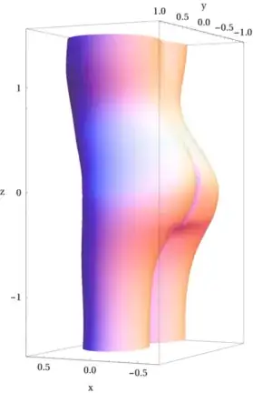

As a long-time user of Mathematica I can tell you that one of its great strengths are the vast amount of possibilities you have to visualize abstract concepts. In the past, we have for instance created highly pleasing analytical surfaces
butt

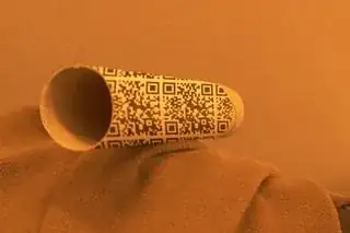

We have used it to create perspective projections of QR codes to make them readable from impossible angles
qr

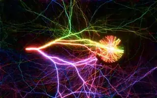

In addition to that, I pointed him to the topic of rewriting systems that are used to create plant-like structures and fractals, and reaction-diffusion systems that can be used to re-create patterns of seashells:
enter image description here enter image description here enter image description here
