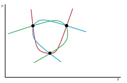

If we allow the standard parabola to rotate, dilate and freely move across a Euclidean plane, then we can define at least one parabola from any 3 distinct points not aligned on a straight line.
Is this parabola unique? If not, how many different parabolas can be formed from any 3 distinct points?
My intuition tells me 3, but I'm not seeing any obvious way to show this (if it's accurate, that is).
A quick sketch of what I mean (sorry for the poor drawing accuracy) enter image description here
Here we have 3 parabolas being formed by the same 3 distinct points.

There are infinitely many.
Given three non collinear points, you can uniquely define a parabola of the form $y = a(x+b)^2+ c$ which passes through the three points. Now rather than rotating the "parabola", think in terms of rotating the plane.
Define new axes $y'$ and $x'$, so that both of them have been rotated by some $\theta$ from $x$ and $y$. Then your three points are still not collinear, and you can find a parabola $y'=a'(x'+b')^2+c'$ which passes through the points. This parabola is "pointing in the $y'$ direction" (I'm not sure what the terminology is, but I mean a tangent to the vertex of the parabola is parallel to the $x'$ axis.) But then $y$ and $y'$ are in different directions (shifted by $\theta$) so the parabolas must be distinct.
You can do this for all but three values of $\theta$, so there are infinitely many choices of $\theta$, and hence infinitely many parabolas. (Check the comments under my answer to see why three values of $\theta$ don't work.)

  • "still not collinear" may fail - but only in three out of continuum-many cases – Hagen von Eitzen Jun 02 '17 at 06:23
    Actually you cannot do it for every $\theta$, as for some values of $\theta$, two of the points will have the same $x'$, and therefore there cannot be a function whose graph goes through both points in that coordinate system. Of course that doesn't really change your argument, as there are only three such exceptions. – celtschk Jun 02 '17 at 06:24
    Nice, thank you, I didn't think about that case. – Harambe Jun 02 '17 at 06:25
  • @HagenvonEitzen: Three points are collinear if they lie on a common straight line. Since rotations map straight lines to straight lines, collinearity is preserved by them. I guess you thought of the condition of two points being vertically aligned. – celtschk Jun 02 '17 at 06:26
    I wouldn't say "vertex of the parabola is parallel to the $x′$ axis": the vertex is a point and thus isn't parallel to anything. (Perhaps you mean the tangent line to the parabola at the vertex?) But you could also just say that the parabola's axis of symmetry is parallel to the $y'$ axis. – Greg Martin Jun 02 '17 at 07:44
  • But why must the parabolas in the different $x'$, $y'$-planes be oriented as you describe? With the tangent on their vertex parallel to the $x'$-axis? – Stephen Jun 02 '17 at 17:00
  • @celtschk it isn't really a concern if two points have the same $x'$ value as we are not so much study functions rather algebraic varieties – Birch Bryant Jun 03 '17 at 16:25
  • @user253929: Shaneye2020's ansatz is exactly to look at it as rotated functions; therefore it fails for those rotations where there's no such function. This ansatz works for parabolas because there's always a rotation where the rotated parabola is described by a quadratic function. – celtschk Jun 04 '17 at 08:04

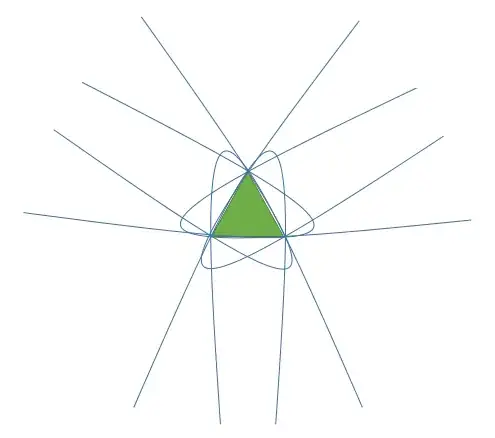

A more difficult question is when the shape of the parabola is fixed, i.e. you can only translate it and rotate it. Then it has only three degrees of freedom and the number of solutions must be finite. In the case of the vertices of an equilateral triangle, there can be at least six of them, by symmetry, as the figure shows.
In the general case, let the parabola have the equation $x=ay^2$, where $a$ is fixed. Then integrating the rigid transform, we need to solve the system
$$\begin{cases} x_0\cos\theta-y_0\sin\theta+t_x=a(x_0\sin\theta+y_0\cos\theta+t_y)^2\\ x_1\cos\theta-y_1\sin\theta+t_x=a(x_1\sin\theta+y_1\cos\theta+t_y)^2\\ x_2\cos\theta-y_2\sin\theta+t_x=a(x_2\sin\theta+y_2\cos\theta+t_y)^2\\ \end{cases}$$
for $\theta, t_x$ and $t_y$.
By subtraction, we can eliminate $t_x$ and we get two equations linear in $t_y$. $$\begin{cases} x_{01}\cos\theta-y_{01}\sin\theta=a(x_{01}\sin\theta+y_{01}\cos\theta)(x'_{01}\sin\theta+y_{01}\cos\theta+2t_y)\\ x_{02}\cos\theta-y_{02}\sin\theta=a(x_{02}\sin\theta+y_{02}\cos\theta)(x'_{02}\sin\theta+y'_{02}\cos\theta+2t_y)\\ \end{cases}$$
Then eliminating $t_y$, we obtain a cubic polynomial equation in $\cos\theta$ and $\sin\theta$. We can rationalize it with the transform
$$\cos\theta=\frac{t^2-1}{t^2+1},\sin\theta=\frac{2t}{t^2+1}.$$
This turns the trigonometric equation in a sextic one, having up to six real solutions.
The detailed discussion of the number of real roots seems to be an endeavor. As the minimum radius of curvature is $2a$, when the circumscribed circle of the triangle is smaller than this value, there is no solution.
  • In the case of the vertices of an equilateral triangle, there are at most six solutions, surely? (There may only be three.) – TonyK Jun 02 '17 at 12:58
  • @TonyK: you are right. What I meant is that the figure proves a case with at least six solutions, which is the general situation (I didn't want to comment about the possible degeneracy). By the way, the rest of my answer proves at most six, so that the figure is actually exhaustive. And as I said, discussing the exact number of solutions may be arduous. –  Jun 02 '17 at 13:21
  • Yes. I recommend changing "at least" (which is simply wrong) to "in general". – TonyK Jun 02 '17 at 13:31
  • @TonyK: I want to express that the figure only proves a lower bound, other solutions might exist. –  Jun 02 '17 at 13:36
  • But it doesn't prove a lower bound! The lower bound is three. – TonyK Jun 02 '17 at 13:37
    @TonyK: you didn't listen. On that figure there are at least six solutions. And by the way, the general lower bound for an equilateral triangle is zero. –  Jun 02 '17 at 13:38
Three points determine a circle anyway you wish to place them

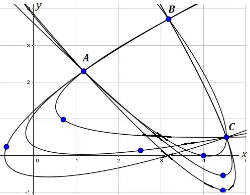

There are infinitely many parabolas through 3 given points.
It can be seen that a parabola equation (eccentricity $ \,e\,= 0$) can be expressed from standard conics definition as
$$ y = C_1x+ C_2 \pm \sqrt {C_3x+ C_4} \tag1 $$
Out of four arbitrary constants if three points are given, then you have a singly infinite set of parabolas through them as shown, 3 points $(A,B,C) $ are fixed and a fourth coincident/double point carefully chosen from Geogebra to form a parabola.
So from the above if you choose one rigid parabolic arc among them, then there is a unique way to fit it back after removing from the 3 given points to re-assemble it.
When fourth point is Java dragged/moved a bit to right along the normal it forms an ellipse and when moved left, a hyperbola. Along the parabola any motion leaves it unchanged proving that the drawn curve is indeed a parabola..standing in its rightful place between the ellipse and the hyperbola. Shown here are three for each set but there are infinitely many for each.
Doubly infinite set of Parabolas
Narasimham
  • 42,260
  • "a parabola anyway you wish to place them": aren't there impossible configurations such as the four vertices of a square ? –  Jun 02 '17 at 08:47
    It is singular case but not impossible case .For the 4 points vertexed at $(\pm1,\pm1)$ the parabola can reduce to either one of two pairs of straight lines $(x^2-1)=0, (y^2-1)=0$ – Narasimham Jun 02 '17 at 09:34
  • Can one decently call that a parabola ? –  Jun 02 '17 at 09:42
    Yes, degenerate case. A pair of straight lines.If an isosceles trapezium made into a square/rectangle, it has nowhere to go. – Narasimham Jun 02 '17 at 10:04
