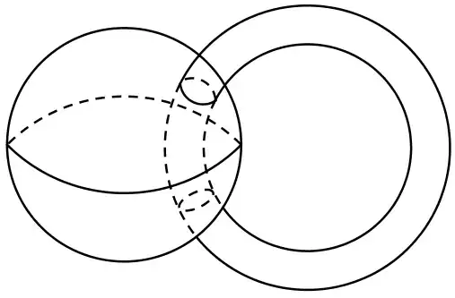

I do not care about the spaces $U$, $V$ in the theorem being non-open - one really ought to make that demand if one is going to decompose the space. However, what do you do when the intersection is not path connected? There are many 'nice' spaces which have this property. For instance, I can easily sketch $3$ in Geogebra:
$1$. $X=U \cup V$, where $U$ is the sphere and $V$ is the torus - and $V$ passes through the sphere at two different circles where it enters/exists the torus. Now $X$, $U$, $V$ are all path connected. $U$ and $V$ are open. But $U \cap V$ is not path connected so the theorem fails.

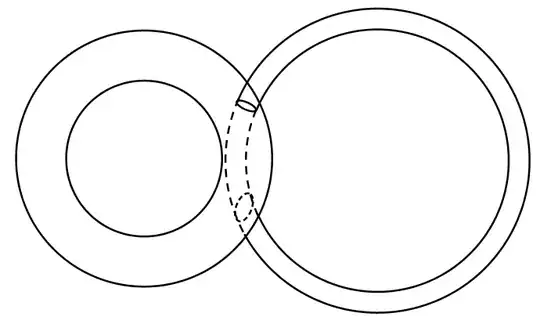

$2.$ The same idea as in $(1)$ but instead we have two tori instead of a sphere and a torus. The issue with the van Kampen Theorem is the same enter image description here

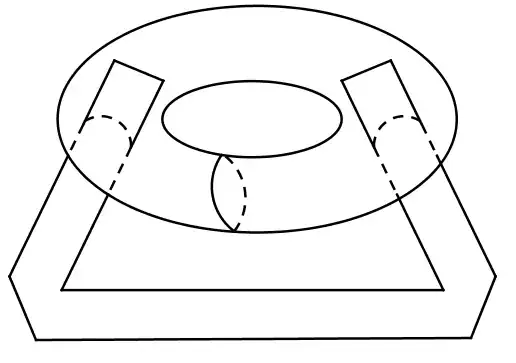

$3.$ $X=U \cup V$, where $U$ is a 'paper strip' and $V$ is the torus. The paper strip enters and exits the torus. Again, each is open and path connected but their intersection is four 'line segments' on the torus - certainly not path connected. The theorem fails again. enter image description here

In each of your examples the $U,V$ are not open. Further, you can find open $U_1, V_1$ such that $X = U_1 \cup V_1$ and Van Kampen applies. In example 1 let $U_1$ be the intersection of an arbitrarily small neighborhood of the sphere with $X$ and $V_1$ be the intersection of an open ball with $X$ such that the ball contains the torus and not all of the sphere. Here we have $U_1 \cap V_1$ homotopic to an open disc. The other examples can be treated similarly.
