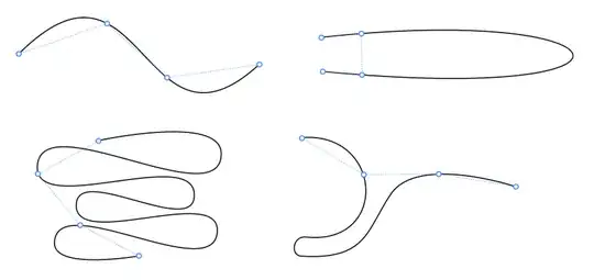

Question: Is it always possible for arbitrary curves $c$ and $n\in\Bbb N$ to equichordally subdivide $c$ into $n$ segments?
It seems not so strange to assume that this might be. However, look at the following examples for $n=3$. The subdivision might not at all follow the shape of the curve or will look similar to a subdivision with equal arc lengths (for small $n$). Most of the time, for a given $n$ the final chord length $\Delta$ is pretty unpredictable.

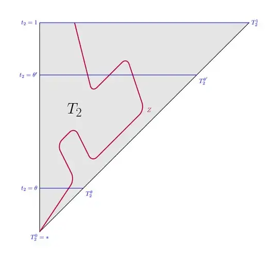

Here's an alternative approach that could work generally. One may be able to reason by induction on $n$ using a connectedness argument. One would need to establish connectedness of a certain level set, but this might be hard.
The proposition is quite obvious for $n=1$. Suppose we know the proposition to hold for $n\geq 1$, that is, suppose we know that for any (continuous, simple) curve $\gamma:[0,1]\to\Bbb R^d$ (I'll take $d=2$) there exist $0\leq t_1\leq\cdots\leq t_n\leq1$ such that, if we set $t_0=0$ and $t_{n+1}=1$, $$\forall k\in\lbrace 1,\dots,n\rbrace,\quad\|\gamma(t_{k+1})-\gamma(t_{k})\|=\|\gamma(t_{k})-\gamma(t_{k-1})\|$$ Note that since $\gamma(0)\neq\gamma(1)$ by non intersection, the $t_i$ must actually all be different, so that in actuality one has $0<t_1<\cdots< t_n<1$.
Now let $c:[0,1]\to\Bbb R^d$ be a (continuous, simple) curve. We shall write vectors $x\in\Bbb R^{m}$ as $x_\bullet=(x_1,\dots,x_m)$ et us define $$T_{n+1}=\lbrace t_\bullet\in\Bbb R^{n+1}\mid 0\leq t_1\leq\cdots\leq t_n\leq t_{n+1}\leq1\rbrace$$ (again, we write $t_0=0$ and $t_{n+2}=1$) and set, for $\theta\in[0,1]$, $$T_{n+1}^\theta=\lbrace t_\bullet\in T_{n+1}\mid t_{n+1}=\theta\rbrace\simeq\begin{cases}* & \text{if }\theta=0\\[3mm]\theta\cdot T_n & \text{if }\theta>0 \end{cases}$$ Let us consider the function $\varphi:T_{n+1}\to\Bbb R_+$ defined by the formula $$\varphi(t_\bullet)=\sum_{k=1}^{n}\Big[\|c(t_{k+1})-c(t_{k})\|^2-\|c(t_{k})-c(t_{k-1})\|^2\Big]^2$$ Note that the sum only goes to $t_{n+1}$. Let us set $Z=\varphi^{-1}(0)$. This is the set of all equichordal subdivisions that start at $c(0)$, but may end before $c(1)$, that is, we drop the requirement that the last chord from $c(t_{n+1}$ to $c(1)$ have the same length as the other chords.
What can we say about $Z$ ?
  1. $Z$ is a closed subset of $T_{n+1}$,
  2. for every $\theta\in[0,1]$, the set $Z\cap T_{n+1}^\theta$ is non empty,
  3. actually, for every $\theta\in(0,1]$, the set $Z\cap T_{n+1}^\theta$ is included in the interior of $T_{n+1}^\theta$ (where all inequalities are strict).
The second point follows from induction : for every $\theta\in[0,1]$, the (continuous, simple if $\theta>0$, constant if $\theta=0$) curve $$c^\theta:[0,1]\to\Bbb R^d,\;t\mapsto c(\theta t)$$ has an equichordal subdivision with $n$ nodes.
Question. Is $Z$ connected ?
Suppose it were, then consider the functions $\Delta^L,\Delta^R:T_{n+1}\to\Bbb R_+$ defined by $$\Delta^L(t_\bullet)=\|c(t_1)-c(0)\|^2,\quad \Delta^R(t_\bullet)=\|c(1)-c(t_{n+1})\|^2$$ Then at the point $t^0_\bullet=(0,0,\dots,0)\in Z$, $$\Delta^L(t_\bullet^0)=0\quad\text{and}\quad\Delta^R(t_\bullet^0)=\|c(1)-c(0)\|^2>0$$ while for every $t_\bullet^1\in Z\cap T_{n+1}^1\;(\neq\emptyset)$, $$\Delta^L(t_\bullet^1)>0\quad\text{and}\quad\Delta^R(t_\bullet^1)=\|c(1)-c(1)\|^2=0$$
Thus, the continuous function $$\Delta^L-\Delta^R$$ switches sign on $Z$. If $Z$ were connected, then there would exist a point where the two functions coïncide, and such a point is exactly an equichordal subdivision.
Here are a few illustrations of this in the case $n=1$ (i.e. $n+1=2$). Consider the curve $c$ drawn in the plane as follows:enter image description here The following represents $Z$ in this particular case : there can be either one, two or three equichordal subdivisions of $c$ with prescribed endpoint and one node, and this is how these possibilities are distributed :
The triangle represents $T_2$ in the plane, the horizontal lines are the $T_2^\theta$ for four values of $0<\theta<\theta'<1$. One sees in this example that the level set $Z$ is path connected. It even looks like a manifold ($c$ is rather smooth).
  • This is essentially the proof from my answer to the original question. I also think the connectivity of $Z$ is the crucial point. – M. Winter May 26 '17 at 17:36

  • @JackD'Aurizio Look at the very curvy example in my question (bottom left). Number the points as $P_0,...,P_3$. The curve $\gamma$ and the bisector of $[P_0,P_2]$ intersect in many points. Which one to choose? You have to give a choice for every step in your algorithm. Otherwise we cannot talk about convergence. – M. Winter May 25 '17 at 21:38
  • Here is a simple counterexample to the claim that the variance of $(c_1,\dots,c_n)$ decreases at each step: https://i.sstatic.net/iNDim.png The dotted line is the bisector of $P_0P_2$. You can mollify the curve as needed to satisfy any smoothness requirements. –  May 25 '17 at 22:26
