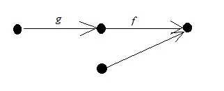

HINTS: This picture should help you with the two that are not true.
The two that are true are pretty easy to prove once you identify them. One of the true ones is the first one; just suppose that $(f\circ g)(x)=(f\circ g)(y)$, and use what you know about $f$ and $g$ to prove that $x=y$. For starters, what can you say about $g(x)$ and $g(y)$, if $(f\circ g)(x)=(f\circ g)(y)$?
