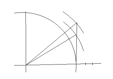

$\sec x = \frac 1{\cos x}$ by definition.
However, there is a nice geometric proof that $\frac {d}{dx} \tan x = \sec^2 x$ that is worth knowing. enter image description here
In the figure we have two right triangles. The base is 1.
Lets call the angle at the center of the unit circle $x, h, x+h$
The heights of the right triangles are $\tan x$ and $\tan (x+h)$ hypoteni are $\sec x$ and $\sec (x+h)$
The areas are $\frac 12 \tan x$ and $\frac 12 \tan (x+h)$
The small triangle with angle $h$ has area $\frac 12 \tan (x+h) - \frac 12 \tan x$
The area of this triangle is less than the area of the section of the circle with radius $\sec (x+h)$ and greater than the section of the circle of radius $\sec x$
These areas are $\frac 12 (\sec^2 (x+h)) h$ and $\frac 12 (\sec^2 x) h$
So,
$\frac 12 (\sec^2 x) h \le \frac 12 (\tan (x+h) - \tan x) \le \frac 12 (\sec^2 (x+h)) h$
or
$(\sec^2 x)\le \frac {\tan (x+h) - \tan x}{h} \le \sec^2 (x+h)$
Now take the limit as h goes to 0.
