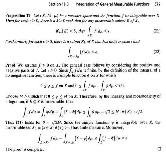

Fix $p\text{ , and }1\leq p\lt \infty.$
By using Lusin's theorem, for any $f \in L^p[0,1]$, for any given $ \epsilon $ $ > $ 0, there exists a closed set $ F_\epsilon $ such that $ m([0,1]- F_\epsilon) < \epsilon$ and $f$ restricted to $F_\epsilon$ is continuous.
Using Tietze's extension theorem, extend $f$ to a continuous function $g$ on $[0,1]$.
Note that $f\equiv g$ on $F_\epsilon$, so we only need to take care of the integral on $[0,1]- F_\epsilon$.
Continuous function is always integrable on $[0,1]$, so $g^p$ is integrable on $[0,1]$.
Since $|f(x)-g(x)|^p \leq 2^p (|f(x)|^p + |g(x)|^p)$ and $f \in L^p[0,1],$
we know $\int_{[0,1]}|f(x)-g(x)|^p \lt \infty, i.e. |f(x)-g(x)|^p$ is integrable on $[0,1].$
By the proposition I post, $ \int_{[0,1]-F_\epsilon}|f(x)-g(x)|^p \to 0 $ when $m([0,1]- F_\epsilon)\to 0.$
Note that $\epsilon \to 0 \Rightarrow m([0,1]- F_\epsilon)\to 0$ (Since $m([0,1]- F_\epsilon \lt \epsilon$)
For each $\epsilon \gt 0$, we can find a corresponding continuous function $g_\epsilon, $ and $\Vert f-g_\epsilon \Vert \to 0$ when $\epsilon \to 0$.
So, $C([0,1])$ is dense in $L^p[0,1]$.
Reference: The proposition is from the Real Analysis,4th Ed, written by Royden and Fitzpatrick.

  • Although my proof looks like a bit tedious, its center thought is simple. The most important estimate is done by the proposition, which is one of well-known properties of integrable functions. – Sam Wong Mar 14 '18 at 17:58
