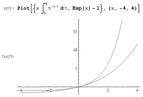

However, this invalid proof doesn't imply that $\sum_{n=1}^\infty \frac{x^n}{n^n} \leqslant e^x-1$ doesn't hold for $x<0$. As a matter of fact, we could observe the following figure, where the lower, $\color{blue}{\text{blue}}$ line is $$\sum_{n=1}^\infty \frac{x^n}{n^n}=x\int_0^1 t^{-xt}\,\mathbb dt,$$ and the higher, $\color{purple}{\text{purple}}$ line is $e^x-1$.
Comparing two plots

    A reformulation: $$e^x-1=\int_0^1 xe^{x t},dt\implies e^x-1-\int_0^1 xt^{-x t},dt=\int_0^1 x(e^{x t}-t^{-x t}),dt$$ so the claim is equivalent to this integral being positive. Rather amazingly, this integral has a closed-form solution according to Mathematica. – Semiclassical Apr 24 '17 at 13:26
  • My last statement in that comment should be disregarded: no such closed-form exists. (User error.) – Semiclassical Apr 24 '17 at 13:32
