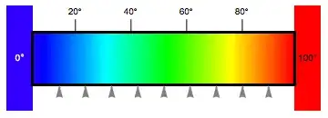

The data, listed below, are from Bevington's book $\S$ $6.1$ which describes temperature measurements for a bar of material abutted by constant temperature heat baths as depicted above.
The measurements are a sequence of $m=9$ measurements of the form $$\left\{ x_{k}, T_{k} \right\}.$$ The model posited in a linear function $$ T(x) = a_{0} + a_{1} x $$

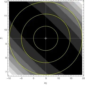

The target of minimization, the merit function $M(a)$, is plotted below. The minimum is marked and surround by yellow rings representing 1, 2, and 3 $\epsilon$ values.
$$ M \left( a_{0}, a_{1} \right) = \sum_{k=1}^{m} \left( T_{k} - a_{0} - a_{1}x_{k}\right)^{2} $$
merit bullseye

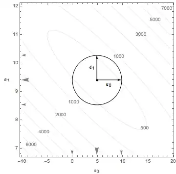

Another view shows the first error ellipse only.
another merit

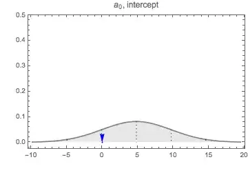

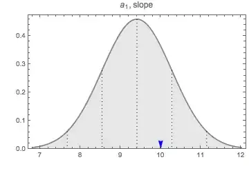

The uncertainty parameters describe the width of the Gaussian distribution. Tighter measurements = better quality = skinnier peak. Below, the distributions for both parameters are plotted against the same scale. Certainly the intercept parameter is a noisier measurement.
a0 a1
For these data, the expectations is that the intercept is $a_{0}=0$ and the slope $a_{1}=10$. Is this consistent with the result? The blue arrowheads in the above figures show the ideal points.

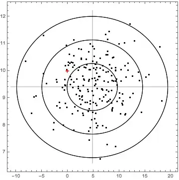

Finally, look at two different ways to envision the statistical variance. Using the Gaussian widths above, two hundred different sets of solution parameters (black dots) were plotted against the measurement (red cross). The rings represent 1, 2, and 3 standard deviations and provide a qualitative feel for how many points to expect in each band.
buckshot

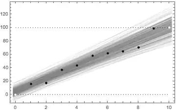

The last plot is a whiskers plot. It takes each of the 200 solutions and plots them against the data set. The white points are the ideal expectations.
whiskers
