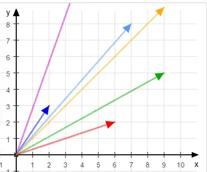

Another comparer is to set a known minimum point and then to compare distances from that point. My set of points is known to be "larger" than that minimum.
For example: enter image description here
I set my minimum to $(0,0)$ and then order all the other points relative to their distance from that point. So we'll get: blue(2,3) < red(6,2) < green(9,5) etc.
