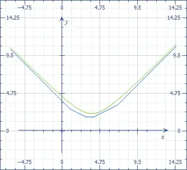

For the sake of the comparison, the plot shows $f_1(x)/4$ and $\sqrt{f_2(x)/4}$ for the points $1, 3, 4, 7$.
