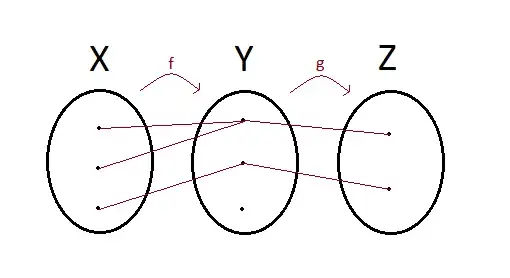

I've already seen a proof by elements showing that this statement is false. However, I want to do a proof by drawing the sets and showing a counterexample where $(g \circ f)$ is surjective but $f$ is not.
We didn't really go over in detail how to do these set drawings, so I think that I figured out a counterexample that disproves the statement, but I'm not confident that I drew it correctly.
surjective_counterexample
I'd really appreciate if someone could let me know if this is logically sound or if I broke a rule I didn't know about, and if so, how I might go about fixing it. Thank you!

Your picture is in itself correct, except that $g$ needs to be a full function.
But why not make it formal:
$X= \{1,2,3\}, Y = \{1,2,3\} ,Z = \{1,2\}$ and define
$$f: X \rightarrow Y\text{ by }f(1) = f(2) = 1, f(3) = 2$$
And
$$g: Y \rightarrow Z\text{ by }g(1) =1, g(2)=2,g(3)=2 $$
Then $f$ is not surjective as $3 \in Y$ is not an image of $f$, while
$$(g \circ f)(1) = g(f(1)) = g(1) = 1, (g \circ f)(2) = g(f(2)) = g(1) = 1, (g \circ f)(3) = g(f(3)) = g(2) = 2$$
Which shows that $g \circ f$ is surjective, as $1$ and $2$ are image points.
