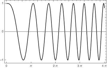

A quick look at the function $\cos \sqrt{x^{3}}$.
cos
