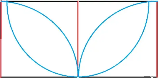

  1. What is the optimal solution where you try to maximise the area which is cleaned but minimise the number of wipers?
  2. It seems like the 4th diagram is probably the solution to the square. But what if only finitely many wipers can be used? What is the solution for each $n$?
  3. What if you do in fact let the sectors overlap? (This will completely change the nature of the problem as it isn't meaningful unless the dynamics of the wipers is considered.)

    Your first example of a legal configuration is the the greedy algorithm. Conjecture: it's the best you can do in the limit; the proportion should be computable. Is it the best you can do with a fixed number of wipers? – Ethan Bolker Apr 15 '17 at 23:52
    This lovely and all but what exactly is the question? Maximize the area by circles one edge of a square, having properties explained above, (provided the constraints admit an optimal solution.) – marshal craft Apr 20 '17 at 01:41
  • I wonder if the 4th drawing is the optimal solution. – marshal craft Apr 20 '17 at 01:47

You have made the assumption that all windscreen wipers require a pivot therefore over complicating things. An optimal solution would be that of two windscreen wipers with the height of the window translating instead of rotating from the middle to the two sides. But say you still want there to be pivots. A smart idea could be three wind screen wipers like below (you must have alternating wiping for overlaps). Blue for circumference covered and red for the wipers. enter image description here
Your 4th diagram does seem optimal but How would the driver see?

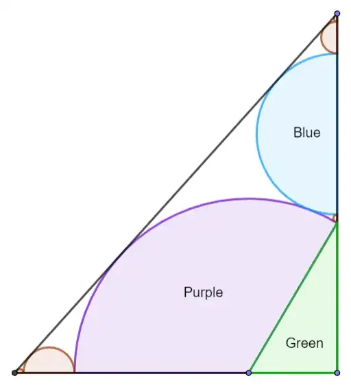

The next logical step would be to consider the case where we have a right angled triangle and we can only place window wipers with their pivot on one of the legs and radius at most the distance to the hypotenuse. This becomes more difficult, not only because the window wipers on different legs influence each other, but also because not all wiping areas have to be semicircles anymore. From here on, let me just lay out some ideas to continue or even finish the proof.
First, let me note that I suspect this triangle case to be optimally solved by placing a quarter circle in the corner, but only if the width and height are within some margin of each other. For the general case, I suspect we want to split into two cases. With or without non-semicircular wiping areas.
First consider the case with non-semicircular wiping areas. Consider the largest non-semicircular wiping area. The rest of the triangle is then split into three regions. Two of them can be at least approximated by the case of Corollary 3 and the final region is again the case we are now trying to solve. Since we are only trying to show a specific configuration is optimal, my idea was to somehow bound the total area of the arbitrary configuration in question using these ideas.
Then for the case without non-semicircular wiping areas. I highly suspect this to never be optimal. For example, if we can place a quarter circle in the corner that does not cut any of the semicircles, then placing this instead of all the semicircles now inside it is obviously a large improvement. However I am having trouble generalizing this argument.
I want to finish off by noting that the conjectured optimal solution has an area of $$\frac{\pi}{2}\left(2-\sqrt{2}+8\sum_{n=1}^\infty\frac{1}{(\sqrt2+2n)^2(\sqrt2+2+2n)^2}\right)\approx0.9697926466...$$ in a unit square. More generally, the largest possible area in Proposition 1 for the function $f:[0,w]\to[0,\infty)$ given by $f(x)=1-\sqrt{1-x^2}$ is $$\frac{\pi}{8}\sum_{n=1}^\infty\frac{1}{\left(n+\frac1w-1\right)^2\left(n+\frac1w\right)^2}$$ if $0<w\leq1$ defines up to where you can place the semicircles.

We can use this proposition to analyze the following case.
triangle
So we have to fill a right angled triangle where all centers have to be on the legs. We consider the case where there is a non-semicircular sector (Purple) touching the hypotenuse. This splits the triangle into three regions: To the left of Purple, above Purple, and the Green triangle. By Proposition 4, it is optimal to place the Blue semicircle touching the hypotenuse and the Purple circular arc. Then all the orange semicircles both on the left of Purple and above Purple follow. The Green region is again a right angled triangle, which makes this problem recursive.
If we let $\varepsilon$ be the width of the Green triangle, we find the total area is a function of $\varepsilon$. Assuming the main triangle has base $1$ and height $h$, the area for $\varepsilon=0$ can be calculated as $$A_0(h)=\frac\pi{4}r^2+(1-r)^2f(h)+(h-r)^2f\left(\frac1h\right),$$ where $r=h/\sqrt{h^2+1}$ is the radius of the Purple circular arc, and $f(h)=(\pi/8)\cdot h/\sqrt{h^2+1}$ is the area found in Corollary 3. Note that the proportional area $A_0(h)/(h/2)\to\pi/4$ both as $h\to0$ and as $h\to\infty$. For $h\in(0,\infty)$, the proportion is larger, taking a maximum of $(3\sqrt2-2)\cdot(\pi/8)$ at $h=1$.
It can be argued for small values of $h$ that the difference between $A_0(h)$ and the optimal area is $O(h^2)$. So we know approximately how well the Green triangle can get filled. For $\varepsilon>0$ we find a total area of $$A_\varepsilon(h)=A_0(h)+\varepsilon\left[\left(\frac12+\frac\pi{8}\right)r+2h(h-r)f\left(\frac1h\right)-2A_0(h)\right]+O(\varepsilon^2).$$ Note that we still use $r=h/\sqrt{h^2+1}$ rather than the radius of the new Purple circular arc.
This gives the derivative of $\varepsilon\mapsto A_\varepsilon(h)$ at $\varepsilon=0$. With Wolfram Alpha, we find this derivative is negative in approximately the interval $h\in(0.5605,6.6187)$, and positive outside this interval. This proves that taking $\varepsilon=0$ is not always optimal, but it is also evidence that it is optimal for $h$ close to $1$.
Finally, the formula for the area in Proposition 1 for the curve $f:[0,w]\to[0,\infty)$, $f(x):=1-\sqrt{1-x^2}$ can be simplified, kind of, by $$\frac{\pi}{8}\sum_{n=1}^\infty\frac{1}{\left(n+\frac1w-1\right)^2\left(n+\frac1w\right)^2}=\frac\pi{8}\left[2\zeta\left(2,\frac1w\right)-w^2-2w\right],$$ with $\zeta(s,a):=\sum_{n=0}^\infty(n+a)^{-s}$ the Hurwitz zeta function. This makes the conjectured optimal area in a unit square equal to $$\frac\pi{2}\left(2\sqrt2-3+\zeta\left(2,1+\frac12\sqrt2\right)\right)\approx0.9697926466...$$ This should allow one to do an analysis similar to my analysis of the triangle, but with a circular sector as hypotenuse.
