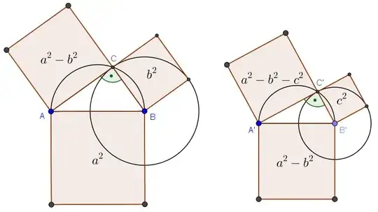

I have actually found out myself now and it is a lot easier than the answer given below. Start with the square of the area $a^2$. Construct a semicircle towards its outside on one of its edges, say $AB$ and then construct a circle with radius $b$ and with centre $B$. Point $C$ should be the point of intersection of the circle and the semicircle. Then ABC is rectangular and Pythagoras tells us that $$|AC|^2=a^2-b^2.$$ Repeat this process now putting the square of area $a^2-b^2$ on the hypotenuse and the one of area $c$ on one of the legs. Then the square on the other leg has area $a^2-b^2-c^2$, as desired.enter image description here

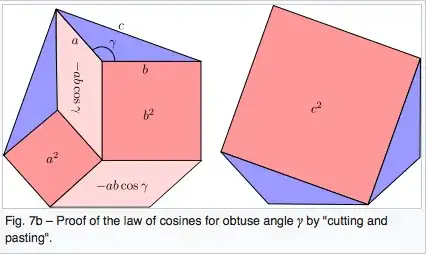

Hint:
It is an application of the law of cosines. This figure is from wikipedia, and (changing $c$ and $a$ with respect to your question) shows that $c^2-a^2-b^2=-2ab\cos \gamma$
The two parallelograms of area $-2ab\cos \gamma$ can be transformed in a rectangle of sides $b$ and $d=|2a\cos \gamma|$, and this rectangle can be transformed in a square with a classical construction (that you can find here).
