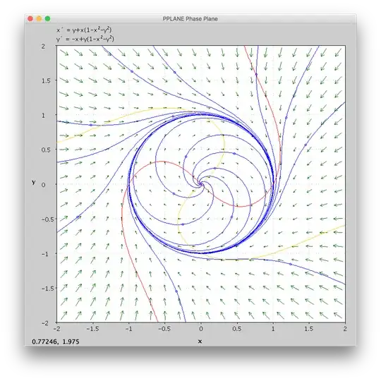

The phase portrait a good place to start.
phase portrait

@Did: Red lines: nullclines where $x'=0$; yellow $y'=0$. Thanks for checking, $\dot{V}$ is corrected.
