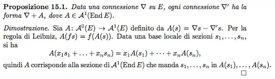

Let $X$ be a complex manifold and $E$ a complex vector bundle on $X$. Straight off my Complex Geometry professor's notes:
Translation:
Proposition 15.1. Given a connection $\nabla$ on $E$, every connection $\nabla'$ has the form $\nabla+A$, where $A\in\mathcal A^1(\operatorname{End}E)$.
Proof. Let $A:\mathcal A^0(E)\to\mathcal A^1(E)$ be defined as $A(s)=\nabla s-\nabla's$. By the Leibniz rule, $A(fs)=f(A(s))$. Given a local basis of sections $s_1,\dotsc,s_n$, one has:
$$A(x_1s_1+\dotso+x_ns_n)=x_1A(s_1)+\dotso+x_nA(s_n),$$
so $A$ matches the section of $\mathcal A^1(\operatorname{End}E)$ that sends $s_1,\dotsc,s_n$ to $A(s_1),\dotsc,A(s_n)$. $\hspace{2cm}\square$
