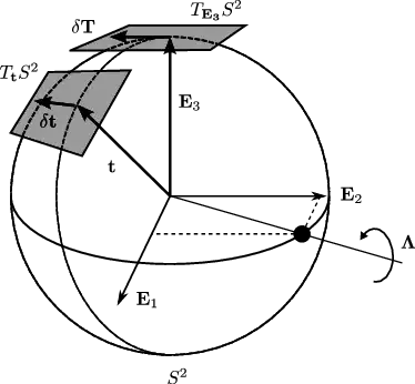

To see why this is ill-defined in general, think about the simplest non-trivial manifold such as the sphere $S^2$ in $\mathbb{R}^3$. At different points $p,q \in S^2$ you have generally different tangent spaces as in the image below:
and so it makes no sense to subtract the tangent vectors. Even if you try and subtract them inside $\mathbb{R}^3$ which makes sense, you won't get a vector that will belong to the tangent space at $p$ or $q$.
The reason everything works in $\mathbb{R}^n$ is that you have a natural notion of parallel transport which allows you to identify tangent vectors at different points using translations in a path-independent way. If you have a vector $v$ whose "origin" is at a point $p \in \mathbb{R}^n$ you can translate it to any other point $q \in \mathbb{R}^n$ so that it will start at $q$ by dragging it from $p$ to $q$ leaving the vector parallel all the time. This does not make immediate sense for general manifolds and leads to the notion of a connection.
