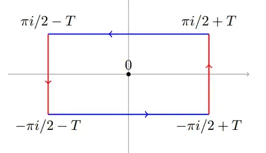

Consider
$$f(z) = \frac{e^{i pz}}{\sinh(z)}$$
If we integrate around a contour of height $\pi $ and stretch it to infinity we get
By taking $ T \to \infty $
$$\color{red}{\int^{i\pi/2+\infty}_{-i\pi/2+\infty}f(x)\,dx}+\color{blue}{\int^{i\pi/2-\infty}_{i\pi/2+\infty}f(x)\,dx}+\\\color{red}{\int^{-i\pi/2-\infty}_{i\pi/2-\infty}f(x)\,dx}+ \color{blue}{\int^{-i\pi/2+\infty}_{-i\pi/2-\infty}f(x)\,dx} = 2\pi i \mathrm{Res}(f,0)$$
Consider
$$\color{blue}{\int^{-i\pi/2+\infty}_{-i\pi/2-\infty}\frac{e^{ipx}}{\sinh(x)}\,dx}$$
Let $x = -\pi i/2+y $
$$ i e^{\frac{\pi p}{2}}\int^{\infty}_{-\infty}\frac{e^{ipy}}{ \cosh(y)}\,dy$$
Similarly we have for
$$\color{blue}{\int^{i\pi/2-\infty}_{i\pi/2+\infty}\frac{e^{ipx}}{\sinh(x)}\,dx}$$
By letting $ x =\pi i/2+ y $
$$ i e^{-\frac{\pi p}{2}}\int^{\infty}_{-\infty}\frac{e^{ipy}}{ \cosh(y)}\,dy$$
The other integrals go to 0 hence
$$i \left(e^{\frac{\pi p}{2}}+e^{- \frac{\pi p}{2}} \right)\int^{\infty}_{-\infty}\frac{e^{ipy}}{ \cosh(y)}\,dy =2\pi i \mathrm{Res}(f,0)$$
Calculating the residue we have
$$\mathrm{Res}(f,0) = \lim_{z \to 0} z\frac{e^{ipz}}{\sinh(z)} = \lim_{z \to 0}\frac{e^{ipz}}{\cosh(z)} = 1$$
Using that we get
$$\int^{\infty}_{-\infty}\frac{e^{ipy}}{ \cosh(y)}\,dy =\frac{2\pi}{e^{\frac{\pi p}{2}}+e^{- \frac{\pi p}{2}}} $$
By taking the real part
$$\boxed{\int^{\infty}_{0}\frac{\cos(py)}{ \cosh(y)}\,dy =\frac{\pi}{2} \, \mathrm{sech}\left( \frac{\pi}{2} p\right)}$$
