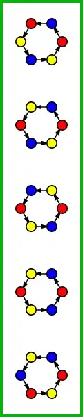

We present the five non-isomorphic proper colorings of the hexagon with two instances of three different colors under rotational symmetry for the reader to peruse in retracing the symmetries.
Coloring the hexagon
The Maple code for this was as follows.

Marko Riedel
  • 64,728
First hint.
Consult this MSE link to learn how a closely related problem was solved.
Second hint.
There is a Perl script that computes the first six proper colorings of an $2n$-gon using two instances of $n$ different colors, with rotational symmetries being taken into account and not being taken into account. The data that were obtained go like this: for no symmetries we find
$$0, 2, 24, 744, 35160, 2394720, \ldots$$
and with rotational symmetries taken into account
$$0, 1, 5, 96, 3528, 199620, \ldots $$
The reader may use these to check their computational results.

More hints as per request
Web resources to consult are
How to compute with the cycle index. Consider the $\varphi(d)$ permutations with cycle shape $a_d^{2n/d}$ where $d|2n.$ We apply Burnside and ask how many of the proper colorings are fixed by these permutations. Note however that no coloring can be constant on a cycle of length $d$ where $d\gt 2$ because there are only two instances of each color, for a zero contribution. This leaves $d=1$ and $d=2.$ The latter case has permutation shape $a_2^n.$ In order to be constant on these $n$ two-cycles we must place a permutation of the two instances of each color on the two-cycles which can be done in $n!$ ways.(This automatically ensures that two identical colors are never next to each other.) We are left to ask how many colorings are fixed by the identity permutation. These are precisely the proper colorings of the $2n$-gon with no symmetries and we can compute these with inclusion-exclusion. The nodes $P$ of the poset here represent colorings where the colors in $P$ are next to each other, plus possibly some more pairs that are also next to each other. The weight of such a node is $(-1)^{|P|}.$ This means that the colorings with no identical neighbors are only included when $P$ is the empty set, for a weight of one. Colorings with exactly $p$ colors next to each other are included in all nodes $Q$ that are subsets of these $p$ colors $P$ for a contribution of
$$\sum_{q=0}^p {p\choose q} (-1)^q = 0$$
because $p\ge 1$ for a total weight of zero. Now to actually count the elements of $P$ we have two possibilities. First, none of the pairs of colors are placed on the special wrap-around slot pair that connects the last element to the first. This gives $\frac{(2n-2p+p)!}{2^{n-p}}$ or $$\frac{(2n-p)!}{2^{n-p}}$$ possibilities. Second, one of the pairs is located on the bridge slot. That means we must choose the pair, for a factor of $p$ and permute the rest, for a contribution of $p\frac{(2n-2p+p-1)!}{2^{n-p}}$ or $$p\frac{(2n-p-1)!}{2^{n-p}}.$$ We thus obtain for colorings with no symmetries taken into account by inclusion-exclusion for $n\ge 2$
$$\sum_{p=0}^n {n\choose p} \frac{(-1)^p}{2^{n-p}} ((2n-p)! + p(2n-p-1)!).$$
This is the following sequence, which is now easy to calculate:
$$2, 2, 24, 744, 35160, 2394720, 222712560, 27154350720, \\ 4205374225920, 806700010233600, 187793061031699200, \\ 52162131258836121600,\ldots$$
Substituting this into the cycle index we obtain for rotational symmetries taken into account
$$\bbox[5px,border:2px solid #00A000]{\frac{1}{2} (n-1)! + \frac{1}{2n} \sum_{p=0}^n {n\choose p} \frac{(-1)^p}{2^{n-p}} ((2n-p)! + p(2n-p-1)!).}$$
We may thus compute the sequence under rotational symmetries, confirming and extending the values from the Perl script, which used enumeration. We obtain
$$1, 1, 5, 96, 3528, 199620, 15908400, 1697149440, 233631921600, \\ 40335000693120, 8536048230528000, \\ 2173422135804796800,\ldots$$
Solving the case of dihedral symmetry
We get for the cycle index
$$Z(D_{2n}) = \frac{1}{4n} \sum_{d|2n} \varphi(d) a_d^{2n/d} + \frac{1}{4} a_1^2 a_2^{n-1} + \frac{1}{4} a_2^n.$$
Observe that the permutations with shape $a_2^n$ swap adjacent beads (those immediately to the left and the right of the axis of reflection) which would have to be the same color as they are on the same two-cycle. This is impossible so this term does not contribute. On the other hand for the shape $a_1^2 a_2^{n-1}$ we must place pairs of colors on the two-cycles, leaving two identical colors on the slots that are fixed and are situated on the axis of reflection. This yields $n\times (n-1)!$ possibilities. We get for our answer
$$\bbox[5px,border:2px solid #00A000]{\frac{1}{4} (n-1)! + + \frac{1}{4} n! + \frac{1}{4n} \sum_{p=0}^n {n\choose p} \frac{(-1)^p}{2^{n-p}} ((2n-p)! + p(2n-p-1)!).}$$
This yields the following sequence.
$$0, 1, 4, 54, 1794, 99990, 7955460, 848584800, 116816051520, \\ 20167501253760, 4268024125243200, 1086711068022148800,\ldots $$
