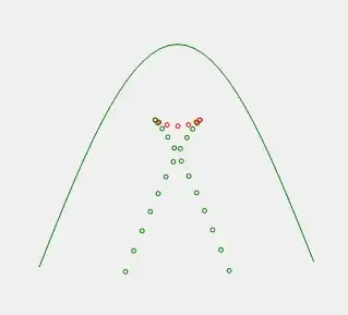

There is a straightforward way to detect the cusps: they arise where the radius of curvature equals the offset distance. In the discrete setting, the osculating circle can be approximated by the circumscribing circle of three consecutive vertices.
In the figure, you see offset vertices, which are in red when the estimated curvature is smaller than the offset. This principle allows to find evidence of self-intersections.
I suspect that the "ladder" formed by the initial polyline and the corresponding offsetted points can help find the intersection efficiently.
