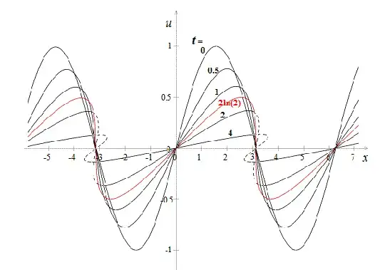

$$u=-\frac{1}{2}x+F\left(ue^{t/2}\right)=-\frac{1}{2}x+\left(X+\frac{1}{2}\sin^{-1}(X)\right)$$ where $X=ue^{t/2}\quad\to\quad u=-\frac{1}{2}x+ue^{t/2}+\frac{1}{2}\sin^{-1}(ue^{t/2})$
$\sin^{-1}(ue^{t/2})=x+2u\left(1-e^{t/2}\right)\quad\to\quad ue^{t/2}=\sin\left(x+2u\left(1-e^{t/2}\right)\right)$ $$u=e^{-t/2}\sin\left(x+2u\left(1-e^{t/2}\right)\right)$$

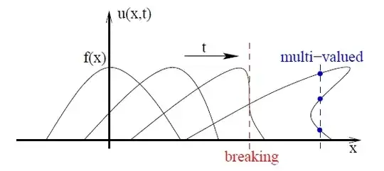

Note that $u(x,t)$ is multivalued for $t>2\ln(2)$ in some range of $x$.

Especially, compare to the next figure taken from this pdf, page 28 :
