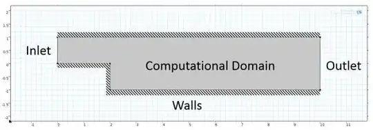

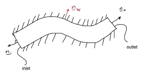

I am asked to give the boundary conditions for the following duct flowenter image description here
We are using a cartesian coordinate system. And $u$ and $v$ are the $x$ and $y$ velocities of the flow. $n_i=(n_{ix},n_{iy})$ is the unit normal vector of the inlet area, $n_0=(n_{ox},n_{oy})$ is the unit normal vector for the outlet area and $n_w$ is the unit normal for the walls.
I would guess that the following boundary conditions are necessary:
  • Boundary conditions on wall: $(u,v)=(0,0)$ at the wall (no-slip + no-through)
  • Inlet condition:$(u,v) \cdot (n_{ix},n_{iy})$ is given.
  • Outlet condition: $(u,v) \cdot (n_{ox},n_{oy})$ is given.
Are my boundary conditions right? I am a little bit confused because our solution says $u\cdot n_{ix} +u\cdot n_{iy}$ (inlet), $v\cdot n_{ix} +v\cdot n_{iy}$ (inlet), $u\cdot n_{ox} + u\cdot n_{oy}$ (outlet) and $v\cdot n_{ox} + v\cdot n_{oy}$ (outlet) need to be specified.

The acccompanying picture illustrating the boundary conditions is resemblant to the OP's:
Then the article says: The fluid velocity is specified at the inlet and pressure prescribed at the outlet. A no-slip boundary condition (i.e., the velocity is set to zero) is specified at the walls.
This means that, at the inlet area, the full velocity vector field must be specified: $(u_i,v_i) = (U,V)$. If there is no reason to assume otherwise, then an uniform velocity field may be imposed.
The pressure condition at the outlet area comes as a slight surprise for me, but I think it's more reasonable than trying to impose a velocity field. The reason is that you will get in trouble while trying to fulfull the global conservation laws for mass and momentum. An extreme example is the outlet velocity field $(u_o,v_o) = (0,0)$ that will suck all mass into nothingness; I can only hope that the CFD code will protest against this, but have the sad experience that too often it will not.
If there is no reason to assume otherwise, then an uniform pressure field may be imposed.
Last but not least, the no-slip boundary conditions are commonly assumed to be correct.
If is is assumed in addition that the flow is irrotational, then the no-slip boundary conditions must be replaced by impermeability conditions, of the form $\;(u,v) \cdot (n_{wx},n_{wy}) = 0$ .
The boundary conditions as proposed by the OP for the inlet area are entirely correct for such ideal / potential flow, as it is called : $(u,v) \cdot (n_{ix},n_{iy}) = $ given.
Boundary conditions for the outlet area are: velocities parallel to the normal $\,(u,v)\, //\, (n_{ox},n_{oy})$ . Then let the CFD code be good enough to assure that e.g. global mass conservation is guaranteed.

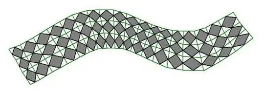

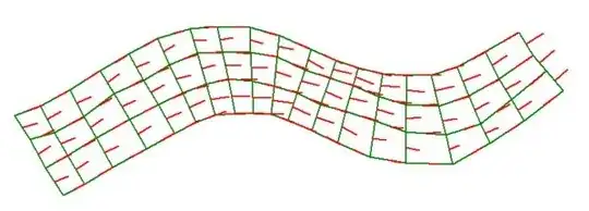

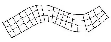

This is what I have done for the OP's problem. First clean up the original picture a bit and make a sketch of the computational grid to be employed:

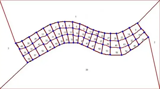

Then find the coordinates of the vertices of the quadrilaterals in the picture, with a little help from a computer program (see bottom of this post):
This is pattern recognition ? Yes it is ! Now we can generate the final (neat) finite element mesh for the purpose of making calculations:
This is very much resemblant to the Finite Difference / Finite Volume / Finite Element mesh in the abovementioned key reference, which is no coincidence of course.
See the last part of my previous answer for (a possible choice of) the boundary conditions.
