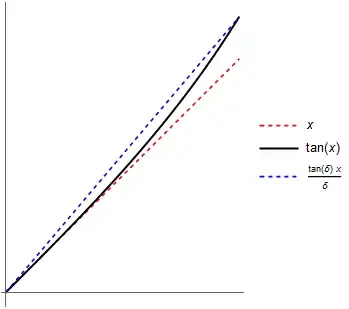

Hint. For $0 \leq x \leq \delta < \pi/2$, we have
$$ x \leq \tan x \leq \frac{\tan \delta}{\delta} x. $$
This easily follows from the convexity of $\tan x$ on $[0,\pi/2)$:
Utilizing this inequality with $\delta = \frac{\pi}{4n}$, we can show that
$$ \frac{\pi}{4} \left( \frac{\pi}{4(n+1)} \right)^{\frac{1}{n}} \leq n \left[ \int_{0}^{\pi/4} \tan^n \left(\frac{x}{n}\right) \, \mathrm{d}x \right]^{\frac{1}{n}} \leq n \tan \left(\frac{\pi}{4n}\right) \left( \frac{\pi}{4(n+1)} \right)^{\frac{1}{n}}. $$
What happens if we take $n\to\infty$?
