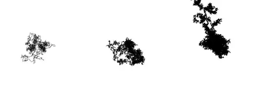

We generalize this by picking a number, and do the prime race $\mod n$. Apart from a couple (certainly finite number of) exceptions, all primes fit in one of the $\varphi(n)$ categories. With this, I mean, let $U(n)=\{u_1,u_2,\cdots,u_{\varphi(n)}\}$ with $0\leq u_i<n$, and $i<j\iff u_i<u_j$, and $\gcd(u_i,n)=1$, then each $u_i$ represents a category; all primes $p$ (except for the ones that are divisors of $n$) must have $p\equiv u_i\mod n$ for exactly one $u_i$. Now we start going through the primes, and whenever we encounter a prime $p\equiv u_i\mod n$, we take a step length $1$ in the direction $\tfrac{2i\pi}{\varphi(n)}$.
An example, $n=8$. This is a relatively easy example to try on grid paper, since $\phi(8)=4$, so we have $4$ directions to go in. For the first $10^3$, $10^4$ and $10^5$ primes, this looks like this (the red dot is the starting point, the blue dot is the end. Open the image in a new tab to see it at full resolution)
racing-mod-eight
Interestingly enough, the red dot, the start, is in all images the right-most point in the entire thing, even though it is seemingly random. So this is the case for $n=4$, and for $n=8$. Maybe it's the powers of $2$, let's try $n=10$ (which happens to have $\phi(10)=4$ as well). We get (again, for the first $10^3$, $10^4$ and $10^5$ primes):

We see this time it's tending more to the bottom-left rather than just the left; but again, one side (the top-right) remains untouched. Let's try this again, but this time with an $n$ without $\phi(n)=4$. We try $n=11$ through $n=15$:
$n=11$ racing-mod-eleven $n=12$ racing-mod-twelve $n=13$ racing-mod-thirteen $n=14$ racing-mod-fourteen and $n=15$ racing-mod-fifteen
We see $n=12$ is very convincingly going to the left and not touching the right, and $n=15$ is leaning towards the top-left, and leaves the bottom-left almost untouched. $n=11$, $n=13$ and $n=14$ however there's no specific way the blob seems to lean.

Why do the blobs with $\varphi(n)=4$ lean so convincingly to one side, while not even touching the other? Do there exist similar patterns for other $n$ with different $\varphi$? Are they related to the fact that the $\varphi$ is a power of $2$ (since $n=15$ has similar behaviour)?

The phenomenon that most of the time, there are more primes $p=3\pmod 4$ than $1\pmod 4$ is known as Chebyshev's Bias. Let $P_{a,b}(N)$ denote the number of primes congruent to $a \pmod b$ $ ≤ N$. Hardy and Littlewood showed that $P_{1,4}(N) - P_{3,4}(N) = 0$ for infinitely many $N$. In other words, $P_{1,4}(N)$ and $P_{3,4}(N)$ switch leads in the prime race infinitely often. However, one residue does not have any siginifant lead over another residue, and as $N → ∞$, $P_{3,4}(N) - P_{1,4}(N) = 0$. This also holds for any integers $a$ and $c$ relatively prime to $b$: $P_{a,b}(N) - P_{c,b}(N) = 0$ as $N → ∞$.
A generalization of Chebyshev's Bias states that most of the time, $P_{a,b}(N) > P_{c,b}(N)$ if $a$ is a quadratic non-residue $\pmod b$ and $c$ is a quadratic residue $\pmod b$. This usually works best if $b$ is prime, but if $b$ is composite, there is more than one way to group the elements $\pmod b$ into quadratic residue and non-residue groups.
For example, let $b=8$.
The elements $1,3,5,7$ are all coprime to $8$, and each odd prime will fall into one of these $4$ categories. Following from a generalization of Chebyshev's Bias, we can assume either of $3$ scenarios:
$P_{1,8}+P_{5,8} < P_{3,8}+P_{7,8}$ (this is the same as the original Chebyshev's Bias, categorized by $-1$ being a quadratic residue $\pmod p$)
$P_{1,8}+P_{3,8} < P_{5,8}+P_{7,8}$ (categorized by $-2$ being a quadratic residue $\pmod p$)
$P_{1,8}+P_{7,8} < P_{3,8}+P_{5,8}$ (categorized by $2$ being a quadratic residue $\pmod p$)
In either case, $1\pmod 8$ appears on the left hand side $3$ of $3$ times, so it would make sense that it might be behind in the race when individually compared to the rest of the residues. As for comparing $3,5,7 \pmod 8$, all of them fall into exactly one residue class, having $-2,-1,2$ as quadratic residues, respectively. Therefore, there appears to be no bias for these three residues and can evidently be seen here.
This phenomenon can be observed $\pmod {12}$ and $\pmod {24}$: $1$ trails far behind the rest of the residues. The more highly composite the modulus $b$ is, the more bias there will be.
This also appears to be the case when comparing primes solely congruent to $3\pmod 4$ with other primes congruent to $3\pmod 4$, with a different modulus $b$. For example, there should be no bias between $P_{7,12}$ and $P_{11,12}$. The argument is simple.
If we look at $-3$ being a quadratic non-residue $\pmod p$, then we can assume that most of the time, $P_{7,12} > P_{11,12}$. However, if we look at $3$ being a quadratic non-residue $\pmod p$, then most of the time, $P_{7,12} > P_{11,12}$, a contradiction. Therefore, there should be no bias between $P_{7,12}$ and $P_{11,12}$.
For general $b$, if $p=3\pmod 4$, then either $b$ is a quadratic residue, or $-b$ is a quadratic residue $\pmod p$, so no residue (already assuming all primes in the race are $3 \pmod 4$) should have any lead over the other.
Edit: I have investigated the prime race $\mod 8$ more extensively. It appears that up to a bound $10^{10}$, there is no integer $1 < N < 10^{10}$ such that .$P_{1,8} > [P_{3,8}$ and $P_{5,8}$ and $P_{7,8}]$ (In other words, $1 \pmod 8$ does not lead the prime race below $10^{11}$). I did compare $P_{1,8}$ with $P_{[[{3,5,7}]],8}$ individually up to $10^{11}$. The only time(s) when $P_{1,8}$ has a lead over any of the other residues is at $N=588067889$, when $P_{1,8} > P_{5,8}$.
I have also attempted to study more generalizations. From numeric evidence, it appears that the more residues $\pmod b$ there are, the less likely that $P_{1,b}$ will be the most behind in the race, but it will still have a tendency to fall behind in the race when compared to the rest of the residues:
For example, $\mod 120$, the only $a$ with no integer $N < 10^{10}$ such that $P_{1,120} > P_{a,120}$ is $a=59$. It is also observed that most of the time, $P_{1,120}$ is not the least behind in the race, it is more likely that it is $2$nd, $3$rd, $4$th least.
List the coprime elements $\pmod b$ from left to right based on the value of $P_{a,b}$ from least to greatest, notice that $1$ will have a tendency to gradually shift toward the right as the modulus $b$ increases, explaining the more darker grids for $n=11,12,13,14,15$ as for your original question.
