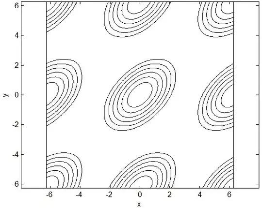

My answer does not address the issue with WA, but shows how to obtain $y$ as a function of $x$ and parameter $z$.

I have plotted with Matlab the curves corresponding to different values of $k$ (see below).

(One should consider this picture as drawn on a torus).
