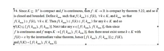

  • @YujieZha posted my answer below, hopefully it is correct. – IntegrateThis Mar 15 '17 at 02:56
My answer in case anyone is interested. I do reference a theorem in my notes though.enter image description here
