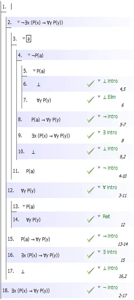

I am trying to prove $$\vdash \exists x (Px \to \forall x Px)$$ with a formal deduction, but I am stumped. Does anyone see what to do?

  • This is a question from my textbook, so I'm not sure how it could be false. The question just asks to show the above is true, though it falls in the section dealing with first-order predicate logic. Informally, we know that $A\to B$ is false only when $A$ is true, and $B$ is false, so we would want that to be the case for the above to be false. – Hugh Mungus Mar 13 '17 at 11:28

  • @HughMungus What specific proof system do you work with? There are many variants! – Bram28 Mar 13 '17 at 13:21
Here is a formal proof ... but remember that the system you have to use may have its inference rules defined differently!
