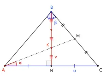

Inspired by your solution, @Blue, and along the same lines, taking the same notations (with $K$ center of gravity at the intersection of median $AM$ and altitude-median $BN$ with $BN=3KN$), I propose a shorter solution that does not use point $P$. Here it is:
Let $u=AN=NC$. We have, by definition of a tangent:
  • $\tan \alpha=\dfrac{KN}{u},$
  • $\tan \beta=\dfrac{u}{BN}=\dfrac{u}{3KN},$
Therefore: $ \ \ \tan \alpha \tan \beta=\dfrac{1}{3} \ \ \ \implies \ \ \ \ \beta=\displaystyle\arctan\left(\dfrac{1}{3 \tan \alpha}\right).$
Remark: I have erased my so complicated previous proof.
Edit by @Blue. This refinement is so good that I had to draw a picture!
$$\tan \alpha \tan\beta = \frac{v}{u}\cdot\frac{u}{3v} = \frac{1}{3}$$
Also, I recommend that OP accept this answer.

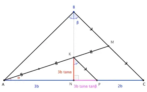

To avoid fractions, take $\angle B = 2\beta$ and $|\overline{AC}| = 6b$. We may consider the problem solved once we have expressed $\beta$ in terms of $\alpha$.
Let the perpendicular from $B$ meet $\overline{AC}$ and $\overline{AM}$ at at $N$ and $K$, respectively. Take $P$ on $\overline{AC}$ such that $\overline{KP} \parallel \overline{BC}$.
Since $K$, as the intersection of two medians, is the centroid of $\triangle ABC$, we "know" that $|\overline{KM}|:|\overline{AM}| = 1:3$. The parallel $\overline{KP}$ carries this ratio over so that $|\overline{PC}|:|\overline{AC}| = 1:3$. That is, $|\overline{PC}| = 2b$, and we have $$|\overline{NP}| = 1b \tag{1}$$
Moreover, $$|\overline{AN}| = 3 b \quad \to \quad |\overline{KN}| = 3b \tan\alpha \quad\to\quad |\overline{NP}| = 3 b\tan\alpha \tan \beta \tag{2}$$
Therefore, $$3b\tan\alpha\tan\beta = 1b\quad\to\quad\tan\alpha\tan\beta = \frac{1}{3} \quad\to\quad \beta = \operatorname{atan}\left(\frac{1}{3}\cot\alpha\right)\tag{3}$$ $\square$
