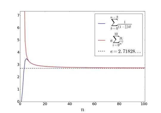

This is just a numerical confirmation of the result derived by Maxim. The figure below shows that Maxim's asymptotic series (red line, truncated to $i=10$ in this example) converges to the original series (blue line) for large $n$, and that both the series converge to Euler's number $e$. enter image description here
