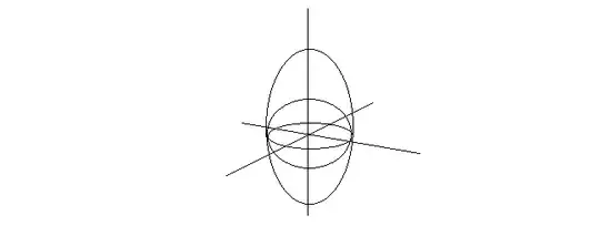

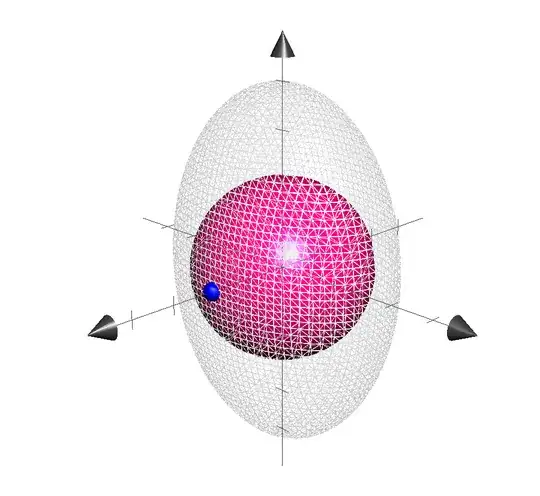

To complement the other answers, we are looking for the points on a given ellipsoid that are closest to the origin. Here is the plot a sphere of radius $1$ touching the given ellipsoid at $(\pm 1, 0, 0)$.

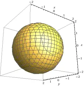

The level surfaces of $f$ are spheres:
The larger the value of $f$, the larger the sphere is.

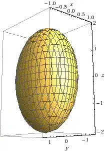

The next figure depicts the constraint which is an ellipsoid:
We get the minimum value of $f$ if we blow up (or shrink) its level sphere so that it is tangent to the ellipsoid from inside.
