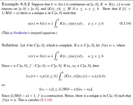

I have been through the contraction mapping theorem, however I have been having trouble understanding it. After the proof I tried to go through the following example but I cannot even understand the notation such as $u(x)$. I would be thankful if someone could give me an insight. Thanks for reading.enter image description here

You have probably heard about Banach fixed point theorem. Please read it first, as there are some detail to it. It approximately says that if we have a function $f(u)=v$, that is contracting, which means
$\exists \hspace{0.5cm}0<q<1\hspace{0.5cm}S.T \hspace{0.5cm}||v_1-v_2||=||f(u_1)-f(u_1)||\leq q \times||u_1-u_1|| \hspace{0.5cm} \forall u_1,u_2 \in D$
then the function $f(u)=v$ has a unique fixed point in the domain $D$. Call the fixed point $w(x)$. Then it should satisfy $f(w)=w$.
So, we need to show that the function $f(u)=h(x)+\lambda\int_{a}^{b} K(x,y) u(y) dy$ is contracting. If we succeed and find a $0<q<1$ for it, then we can conclude that it has a unique fixed point.
Take arbitrary functions $u_1$ and $u_2$. The corresponding outputs are computed and we take their difference to get
$$f(u_1)-f(u_2)=v_1-v_2=\lambda \int_{a}^{b} K(x,y) (u_1(y)-u_2(y)) dy$$
Then, we take norm of both sides. The supp norm is an option. I am going to use the notation $||u||$ for it.
$$||v_1-v_2||=|\lambda| \bigg(||\int_{a}^{b} K(x,y) (u_1(y)-u_2(y)) dy|| \bigg)$$
Now, we should use the given information to make an inequality. Firstly, $|K(x,y)|\leq M$
$$||v_1-v_2||\leq \lambda M \bigg( ||\int_{a}^{b} (u_1(y)-u_2(y)) dy || \bigg)$$
At this step, triangle inequality of a norm comes to rescue.
$$||v_1-v_2||\leq \lambda M \bigg( \int_{a}^{b} ||(u_1(y)-u_2(y))|| dy \bigg)$$
Norm is a complex number and can be taken out of the integral and the remaining integral is the integral of a constant function, over $[a,b]$.
$$||v_1-v_2||\leq \lambda M (b-a) ||(u_1(y)-u_2(y))|| $$
$\lambda M (b-a)$ is supposed to serve as $q$, if it satisfies the mentioned condition in the question.
So, we proved we have a contraction mapping and you can conclude it has a fixed point, that is called $u(x)$ in the question.

  • Thanks, only one question: How did you take the integral sign out in the last step? I have never heard of Banach fixed point theorem, is it the contraction mapping theorem? If it is not, could you please provide me a link to the Banach fixed point theorem? – Pedro Gomes Mar 06 '17 at 18:55
  • Search for the theorem on Wikipedia, with the name "Banach fixed-point theorem". In the last step, as I have mentioned, the norm is a number. So, it can be taken off the integral. Then the integral is $\int_{a}^{b}dy=b-a$. – Med Mar 06 '17 at 19:00
  • Right. Thank you! I have searched the theorem and apparently Banach fixed-point theorem is the same as Contraction Mapping theorem, only the names can be interchanged. Is it true that a function defined on the same metric space $f:(A,\rho)\to(A,\rho)$ is uniformly continuous? – Pedro Gomes Mar 06 '17 at 19:06
    I do not think it is generally true. Just take the function $y=x^2$ as an example. You can have a look at this question http://math.stackexchange.com/questions/1373053/why-is-fx-x2-uniformly-continuous-on-0-1-but-not-mathbbr – Med Mar 06 '17 at 20:02
  • Just a small comment: You probably want to invoke the triangle inequality for integrals before factoring out $|K|$; otherwise you might have, for instance, $u_{2} = 0$, with $K(x, y) = u_{1}(y)$ for all $(x, y)$, $\int u_{1} = 0$, and $|u_{1}| > 0$, yielding a questionable deduction between your second and third displayed integrals. (Your fourth displayed integral, the one that matters, is still OK, of course.) – Andrew D. Hwang Mar 06 '17 at 20:51
