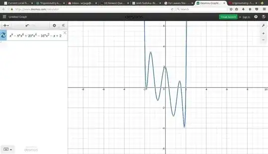

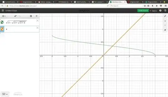

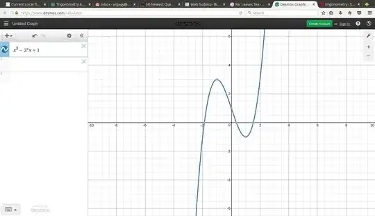

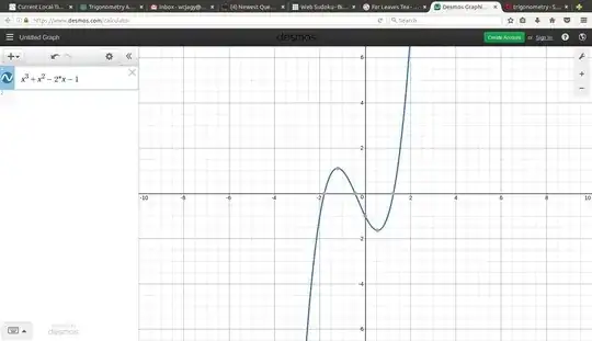

Taking $$ x = 2 \sin \left( \frac{\pi}{18} \right) \approx 0.347296 > \frac{1}{3} $$ we are told $$ x = \sqrt{2 - \sqrt{2 + \sqrt{2 + x} }}. $$ Put another way, we are demanding a fixpoint of the real valued function $$ f(w) = \sqrt{2 - \sqrt{2 + \sqrt{2 + w} }}. $$
I repeatedly squared and put the polynomial terms on one side, which led to $$ x^8 - 8 x^6 + 20 x^4 - 16 x^2 - x + 2 = 0. $$ This factors, $$ \left(x-2 \right) \left( x+1 \right) \left(x^3 + x^2 - 2x+1 \right) \left( x^3 - 3x + 1\right) $$ You can see from the graphs that $x \approx 0.347$ can only be a root of the final cubic, $x^3 - 3x + 1.$ Call your quantity $s$ so that $x = 2s,$ we get $8 s^3 - 6 s + 1 = 0.$
enter image description here enter image description here enter image description here
Notice that, while the octic polynomial has eight real roots, the original function has just a single real fixpoint. enter image description here

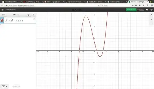

Here's a good one. Find the roots of $$ x^3 + x^2 - 4 x + 1. $$ Very trigonometric.
Will Jagy
  • 146,052
  • Can you explain more about your answer ? – S.H.W Mar 05 '17 at 20:22
    @S.H.W just a good example, with quite pretty outcome. I still have no idea what your question is. Since this has three real irrational roots, it falls under https://en.wikipedia.org/wiki/Casus_irreducibilis However, very nice answer if we include trigonometric functions. – Will Jagy Mar 05 '17 at 20:26
