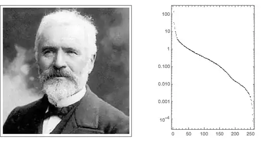

For illustration, examine the 256 $\times$ 256 matrix below, an image, and the spectrum of singular values plotted on the right. For instance, you may decide that if the singular value is less than $10^{-10}$ it will be set to $0$.
Camille spectrum
It sounds like your singular values suffer the common malady of being a small number instead of $0$.
