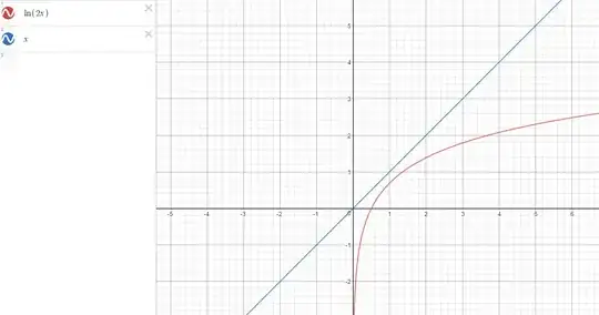

$$e^x = 2x$$ $$\text {Take ln of both sides}$$ $$\ln(e^x) = \ln(2x)$$ $$x = \ln(2x)$$
These two do not intersect, thus there is no solution.
