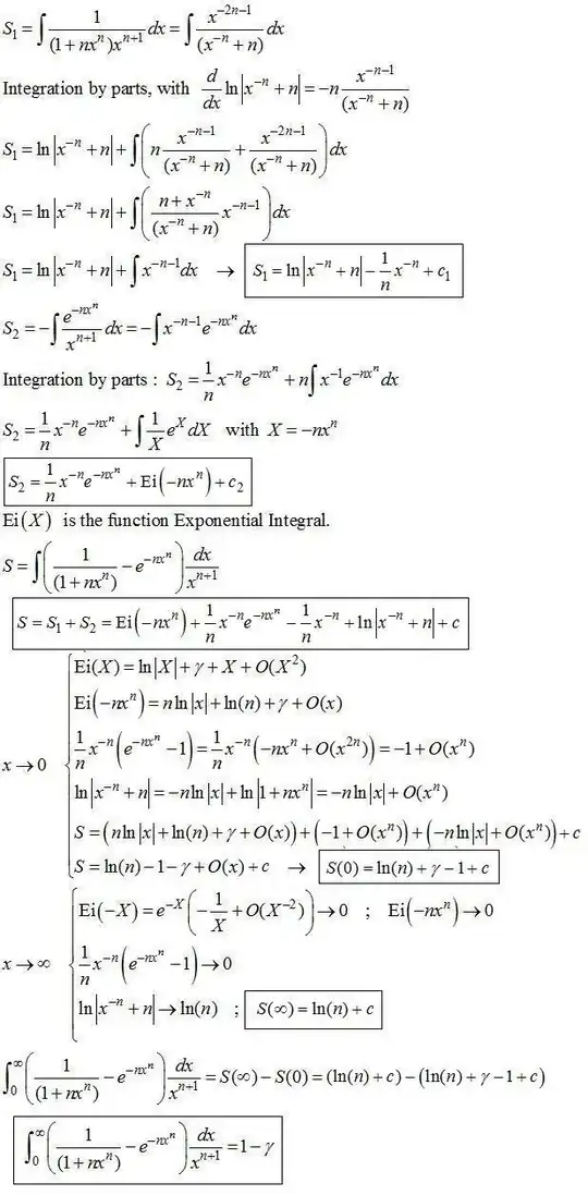

Claude Leibovicy already send a nice answer, while I was still typing.
Nevertheless, I joint my answer. Even if not smart, solving by brute force :
JJacquelin
  • 68,401
  • 40
  • 91
